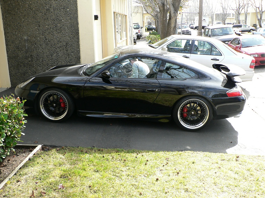

Hey All,

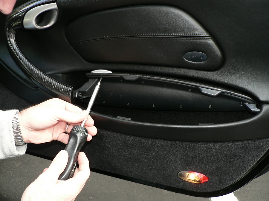

I just wanted to show an install we did today for 6speeder LilStan. He brought in his sweet ’99 C2 to replace his old yellowing/fading OEM 996 carbon fiber door side pocket covers with some MAcarbon pieces. This presents a good contrast as we did the door pulls a few months ago – the color difference between our parts and the old OEM is pretty obvious with such big pieces.

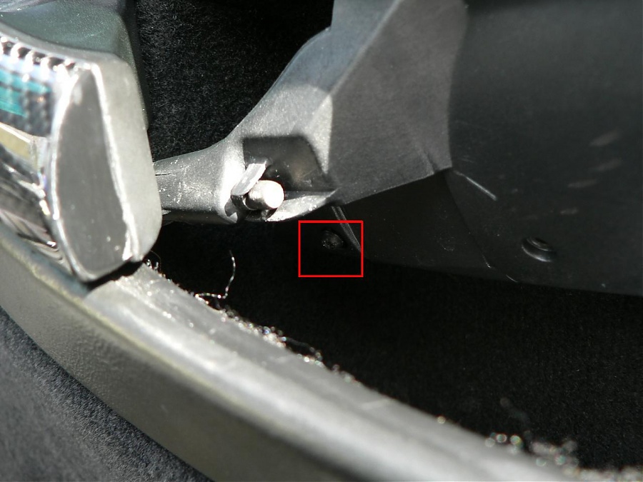

The installation process for these pieces pretty straight forward….probably a 30min job with the right tools. Of course, we didn’t have the right tools and it ended up taking an hour to do, but it all worked out in the end.
Tools: Size 10 Torx bit
Narrow/small ratchet!

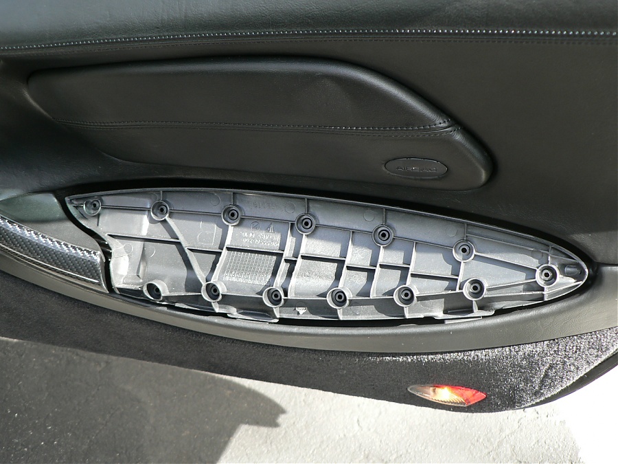

For the install, we decided to remove and install the covers in place rather than remove the flap mechanism. This reduced the amount of removal/reinstall work. The covers are each held on by thirteen(!) torx screws. The lower edge is easy to do but when cover is flipped up, the top screws go down into the map pocket. It’s pretty small so there is little room for the ratchet or your hands. So getting a right-angled fitting or small compact-type ratchet should make it much easier. We had to learn the hard way J as our ratchet and torx bit was too long to fit and we had to do it by hand. Other than the space issue, the hardest screw to reach was the one located at the very front of the cover. We’ve included a pic highlighting that screw squared in red.

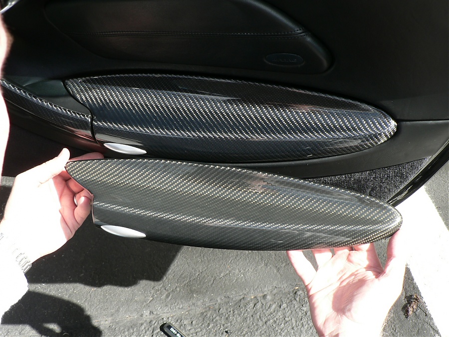

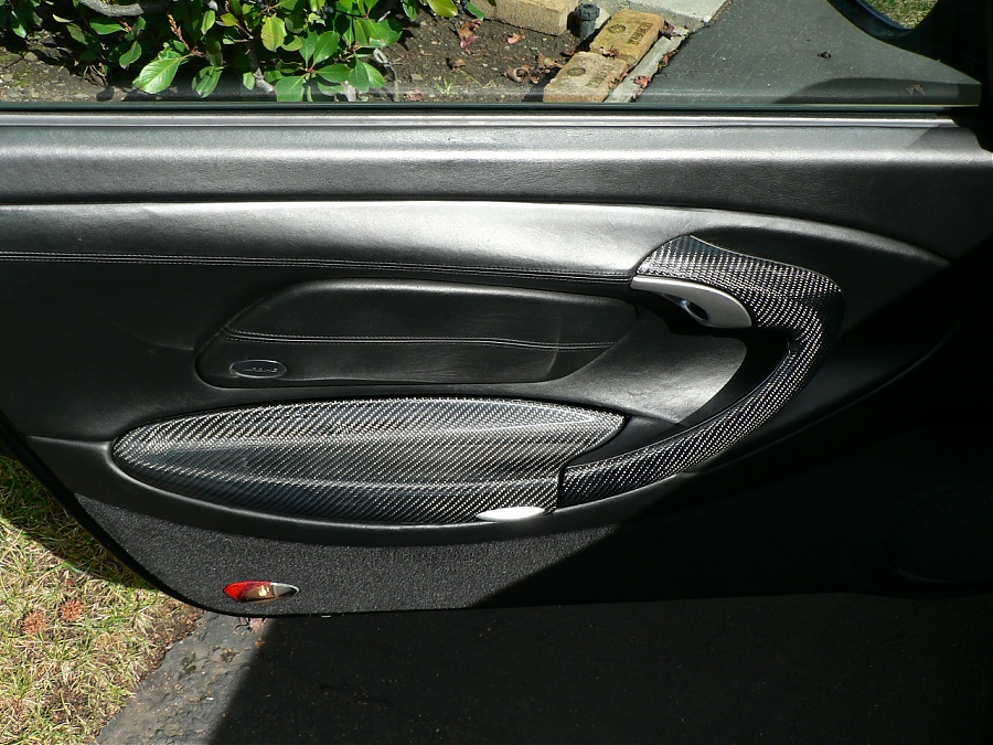

Our before and after pictures really speak for themselves. The contrast of the old OEM carbon pockets with our MAcarbon door handle surrounds is clearly noticeable. So with the old pieces replaced with our new parts, it definitely looks a lot better. Interestingly, we just received a brand new set of OEM door speaker grills and they are almost the same exact color as the old map pocket pieces.

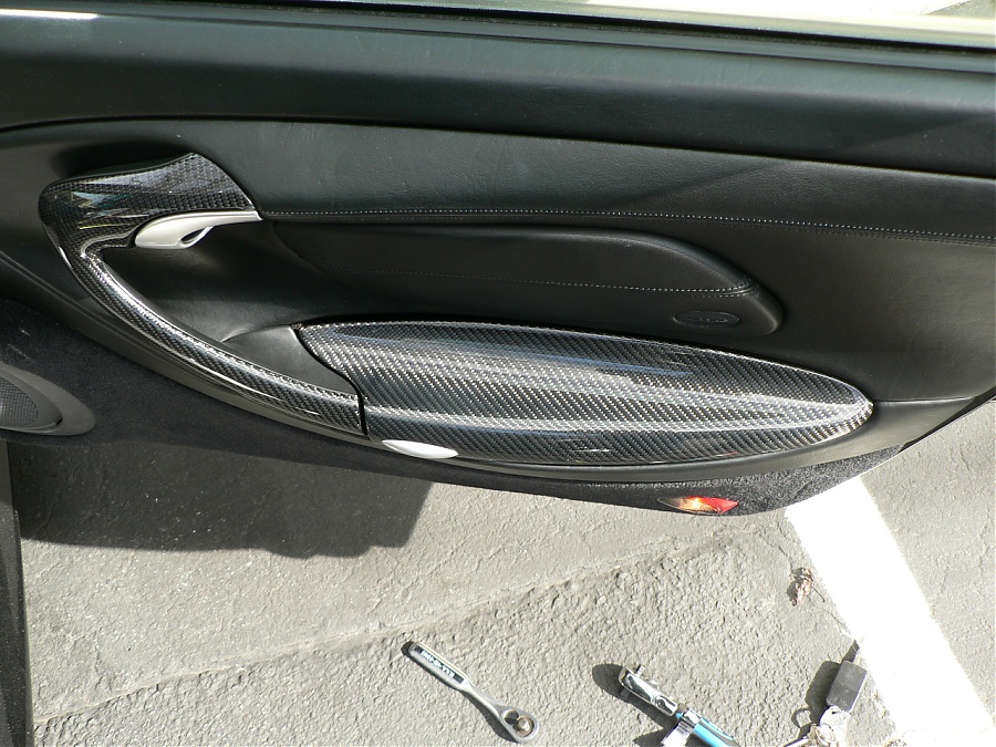

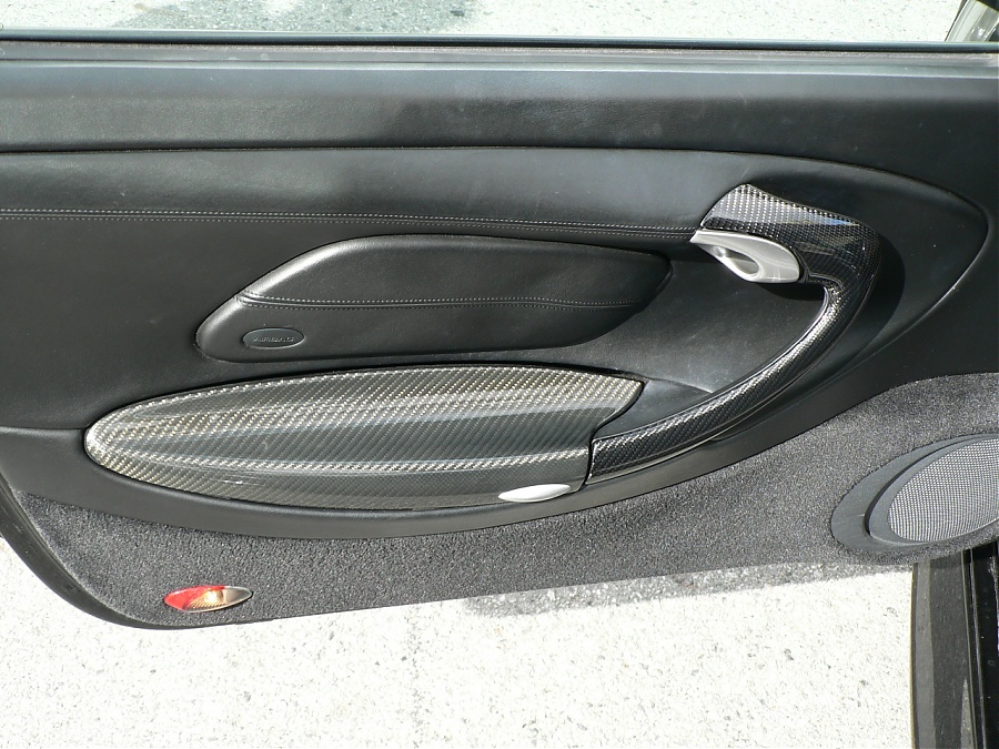

The After Photos
Here are the 'After' photos showing the new lid in place as well as the contrast with the old lid.

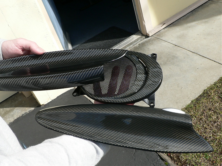

Although the pic doesn't show it as well as I'd like, here is a comparison between the pocket cover that cam of Stan's car, our pocket cover, and a brand new OEM Porsche speaker grill. I do feel green after looking at them! I almost wonder if the grills are NOS!
