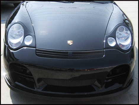

Does anyone ever use those things? I was thinking of covering mine up with this:
