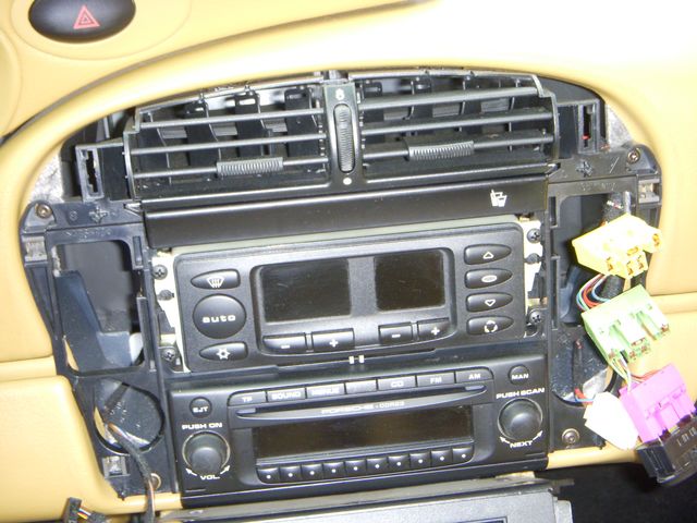

1) Remove the horseshoe molding around the climate control unit and radio. After a few easy snaps, it'll come right off. Gently pry the connectors off the back and place it to the side. Just use your fingers .. no need for tools. See attachment #1.
2) Unscrew the 2 phillips head screws holding the climate control unit in place. Simply pull out the unit and detach the red and black connectors. See attachment #2.

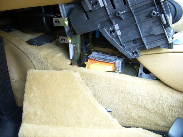

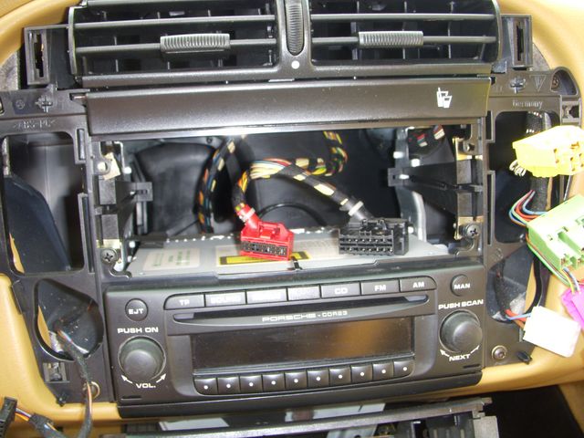

3) Next, remove the leather trim panels surrounding the bottom console. There are 3 plastic "teeth" holding this baby in. Give it a strong tug towards you (and by towards you it means that you are on your belly in the floorboard) ... then slide it towards the back of the car. It'll reveal attachment #3.

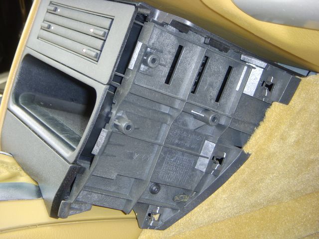

4) Next, remove the carpet panels from each side. This step took a little more muscle, but easily snapped out as well with a good tug. Don't be shy. Again, pull towards you. I think there were 2 "teeth" holding each in place. Once out, well, that's attachment #4.

6) Peering inside the open space where the climate control used to be, you'll see the red and slightly larger black connectors. They are bundled to the same strand of wires .. they are just spit apart. You'll have to feel your way thru this part. I was able to get the red connector to slip thru the metal "hole" easily ... actually, it's not a hole but a long opening in the metal that isn't too wide. The black (and larger) connector was a PIA, but eventually I got it thru too. A simple maneuvering and I was able to bring the single band of wires down to the driver's side footwell. What sucked most about this step was the sticky residue from the tape keeping hte bundle together. See attachment #5.
