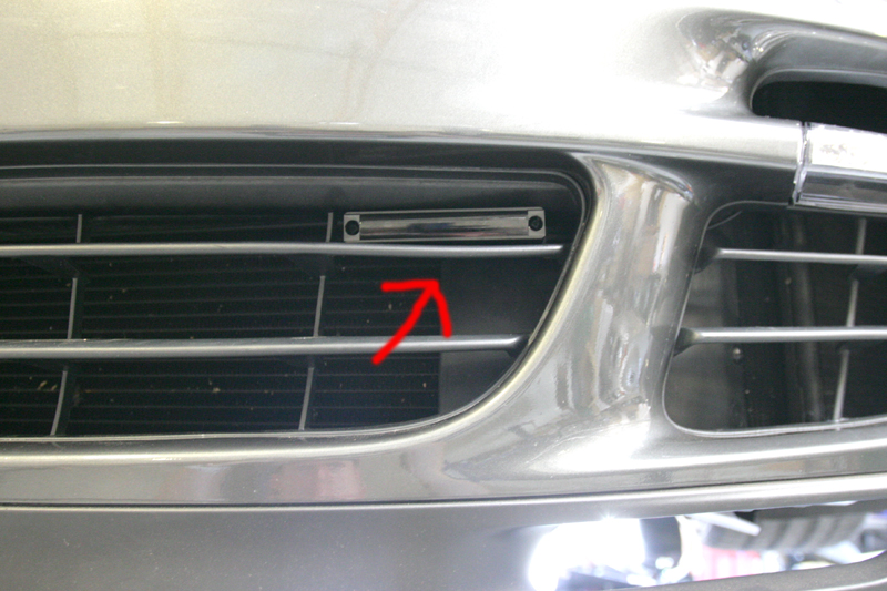

I installed them on my 996TT and my 997TT. We did not take the bumper off at all.
What we did is first mount the 2 units in the grills. Then we snaked the wires up and went underneath the plastic that lines the hood area to the battery terminal. From there there is a pass thru where the CD changer or stock AMP goes to the factory head unit through the fire wall.
On my 996TT, we mounted the on off switch in the center console and the speaker/light behind the radio trim on the left side as pictured. On the 997TT we mounted it on the left side foot well carpet near the door jam to be more "hidden". Hop that helps
These are the only pics I could find... See attached.
