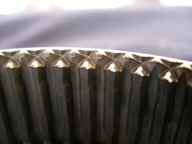

Okay, so here is the deal. We rebuild these gearboxes on a regular basis and it is always the same issue. While this issue is more common in the turbo gearboxes due to more HP and Torque loads, it should not surprise anyone that as these gearboxes use the same 1st and 2nd gear setup, the C2 gearbox has the issue. It is more common in higher mile cars that have not been taken care of as well, but blown shift into second will do the trick just the same.
I will post a pic here in a second and you can all see what I am talking about.
Hope that this helps, and while I am sure that you love your car, it is a pretty far stretch to say that these gearboxes are bullet proof, sorry.

So here are the pics
Here are the pics for your review. I have taken pics of dogring on the gear as well as the slider for 1st and 2nd. I have also take a pic of the G50 2nd gear so that you can see the difference here, and it is pretty big. The rounded off parts are supposed to look like the clean gear also pictured, not rounded off, but pointed. As these parts round off, they create damage to the operating sleeve, as well. Given enough time and damage, as well as a weak detent system, and the gearbox will begin to pop-out, or simply not engage at all.
Hope these pics help to clear up what actually happens when these gearboxes fail.

It is a little tough to tell here but the teeth on the G96 are substancially smaller then the teeth on the G50 gear, there are more of them, but the actual engagement area is far more shallow.
