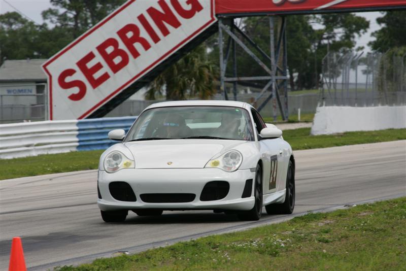

I would but I'm in Miami for the weekend. I went last year and it was very cool. Have a margarita at Tommy Bahama Cafe for me :-)
I've talked to Joe Vatter at German Tech about brake cooling. If I still had an issue, I'd be running a duct straight to the caliper like what we used to do on the older 911's. I have a Gemballa style front bumper and wouldn't mind some kind of duct attached straight to a hose going straight to the caliper. The old ones weren't even that big....maybe 2 inches in diameter. For what it's worth, Joe would like me to go to Pagids next....that's what they use all the time.
Do we know each other? Dunedin's not that big.....
This pic is pre coilovers. It about drags on the track now

Haven't seen yours before. Here's mine:
Why aren't you going to Vortex to get your work done?
