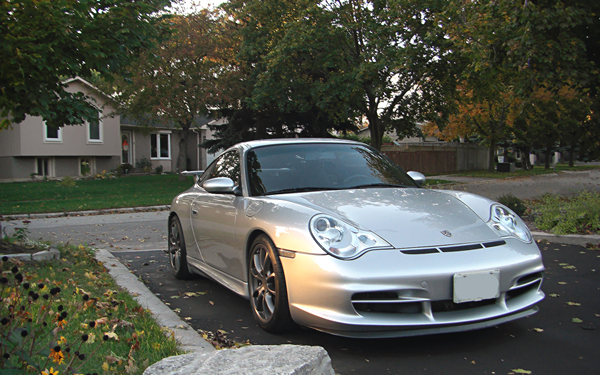

We saw a pic of another 996 with them on, so we're guessing they should fit without much issue. See pics below.
That said, this is a friend's car and he's been eyeballing 19s for a while now for their aggressive size, but with the overwhelming preference for the GT3 rim style, the 18" GT3 rims as came with the 6GT3s is an alternate option and will fit without drama. So we'd like your opinion, if you had your choice of the 18" GT3 rims, or the 19" Carrera Sports which would be your vote?
19" Carrera Sports:
18" 6GT3 rims:

Thanks for the pics of the carrera sports on a nb 996; I hadn't seen any before.
I think the sports are one of the nicest wheels Porsche has offered. Regarding your choice; from a performance perspective the 18's will work better. Esthetically I think the 19" sports look better.

Thanks. Everything we've read and everyone we've talked to say no way 12" wide wheels will fit. 11.5" is the max I've heard of. But I think 12s can be done and look right. The alternate is the Carrera Sport wheels which are 11.5", which has been photoshopped on from another 997 GT3 and should fit without machine work.

We finally fitted the 11.5 Carrera Sports on the 996 and it fit with plenty of clearance. In the end 12s should fit the rear no problem, and the fronts could actually be another 1/2" wider to the outside. We are looking in to spacing the fronts another 12-14 mm out.
I cut the lower inner portion of the fender liner away where it bulged out against the inside of the rear tire. On the 7GT3, this is also cut away, with a duct coming through to cool the rear brakes. There is probably another inch or inch and a half of clearance on the inside afterwards.
The 7GT3 wheels offset out about 5mm too much if you use a -1.25 rear camber. You either have to go with a -2.0 camber, or modify the offset as I described previously and all should work fine. There really is little difference between the rears of a 996 and 997.
