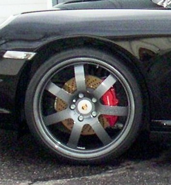

Originally Posted by jhbrennan
In addition, 20's really make the brake rotors look tiny.
Old Feb 18, 2009 | 01:44 PM
jhbrennan's Avatar
Joined: Apr 2006
Posts: 5,260
From: Austin
Rep Power: 770
Originally Posted by deckman
Here's a 20 on a 997 C4S front - my immediate focus is on the rotor, not the wheel. Maybe more spokes would hide the size disparity.
