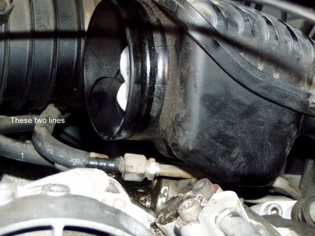

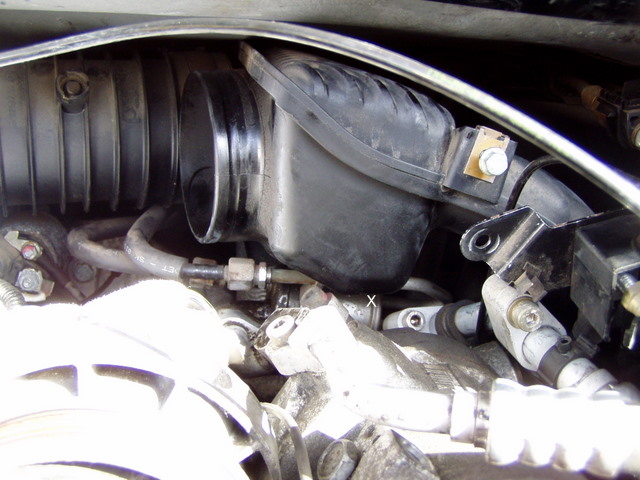

Finally, there are two lines connected to a device mounted to the top rear of the compressor that at first looked like a receiver/dryer. The lines are too short to pull the compressor out of position. In looking at PET this device may be the “fuel cooler” which shows two lines connected to it, but the manual does not mention this device or the fines to it. If they are fuel lines I should be able to disconnect them with loosing the charge on the compressor (which is the whole point in removing the compressor after all). Anyone with any advice on this?

Herer are some pictures fo the two lines and the device attached to the rear of the AC Compressor. any ideas on waht they are would be appreciated.
