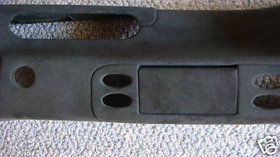

[IMG]file:///Users/Jam/Desktop/%21BVM3+hw%21mk%7E$%28KGrHgoH-CMEjlLly1TnBKRSBqte-w%7E%7E_0.JPG[/IMG]here a 996 console
Old Jul 7, 2009 | 08:38 PM
  #52
KrissrocK's Avatar
Joined: Mar 2009
Posts: 115
From: PA
KrissrocK is infamous around these parts
man that looks tight!

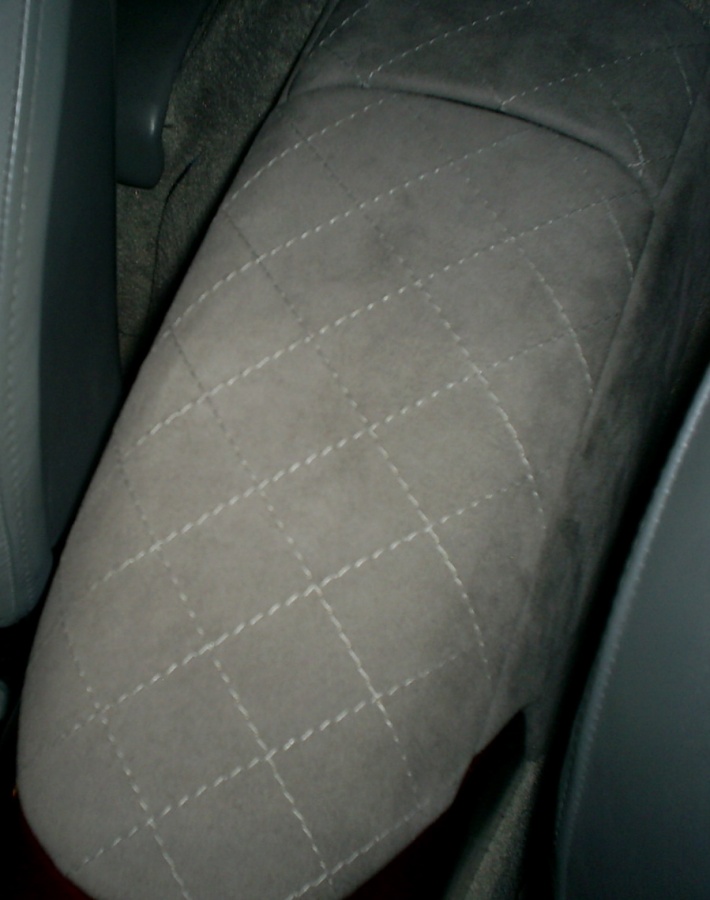

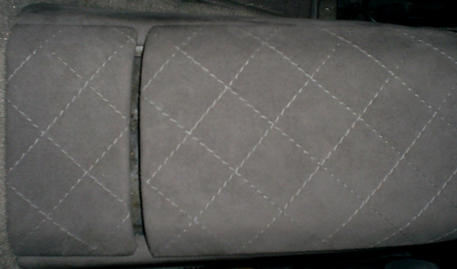

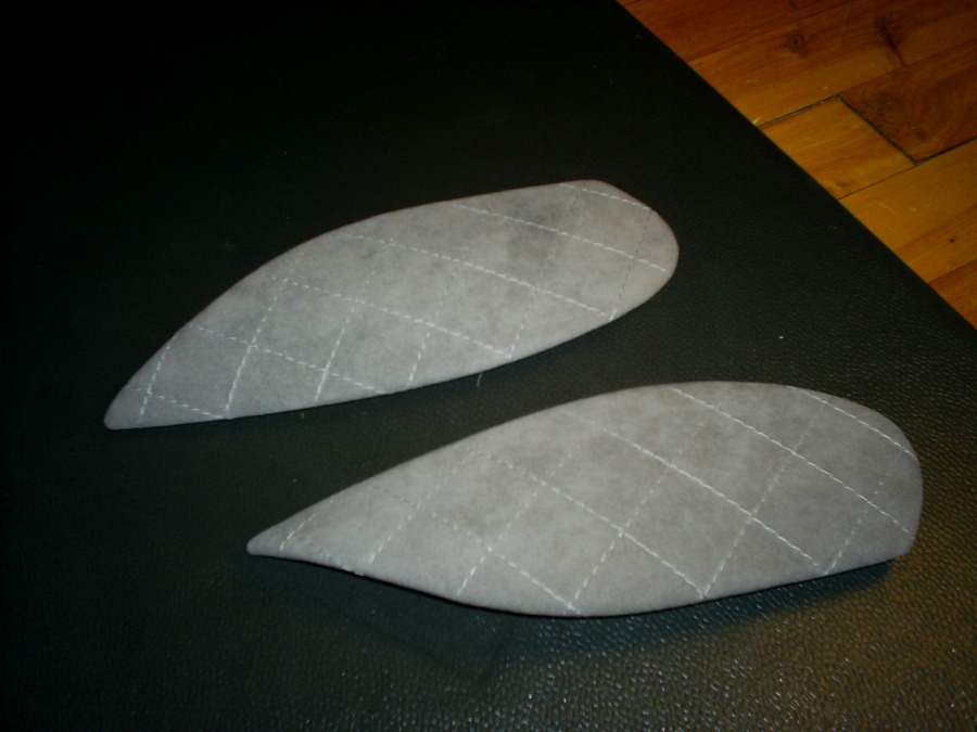

chuck, that is not from my car, not easy but doable.. use 3m 80-90 adhesive glue.
here is some pics of my interior trims in alcantara.
sorry using cheap camera, looks way nicer in real!

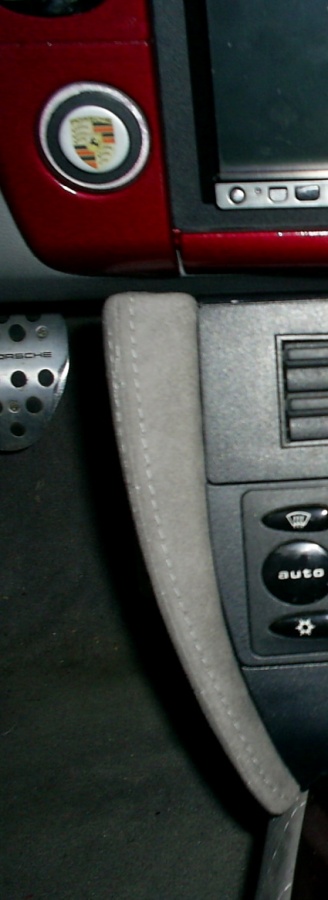

some more...

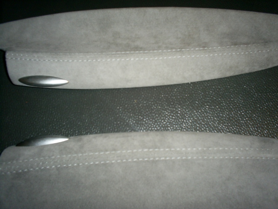

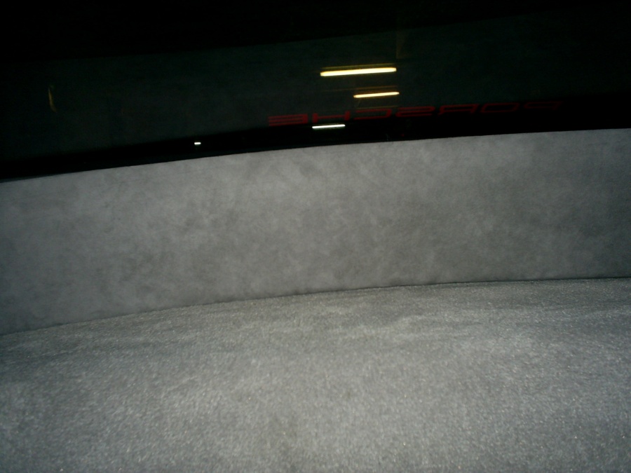

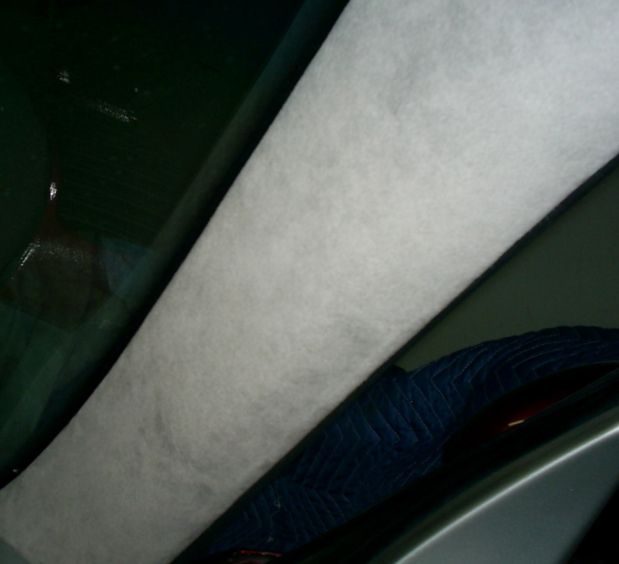

some more,
Ive also done the headliner along with suroof liner.

Great look Jam. Was the Alcantara from Gulf Fabrics? I was going to order Jet Black and do the same areas you had covered. How did you glue it on the door pulls? Did you find it necessary to put the stitching on the door pockets to get it to fit? I was going to go without stiching since I am cheap and can't do that myself.
Old Jul 9, 2009 | 09:06 AM
  #58
KrissrocK's Avatar
Joined: Mar 2009
Posts: 115
From: PA
yeah, stitching is some professional stuff!!
also when i talked to the guy at gulf, he told there's a Panel weight and Normal weight Alcantara...One made for seat coverings, and one made to cover door panels and other stuff. The panel sample i have seems to have a backing to it, but it doesn't stretch at all...Do u know which type of alcantara those peices were done it?
Old Jul 9, 2009 | 04:38 PM
  #59
Jam996's Avatar
Joined: Apr 2008
Posts: 682
From: Toronto
Rep Power: 58
Jam996 has much to be proud ofJam996 has much to be proud ofJam996 has much to be proud ofJam996 has much to be proud ofJam996 has much to be proud ofJam996 has much to be proud ofJam996 has much to be proud ofJam996 has much to be proud ofJam996 has much to be proud of
Got it from gulf fabrics, stitching is not necessary, but give it a nicer detailed look.
I did diamond quilt stiching with french seams.
Buy panel alcantara, and use 3M 90 adhesive spray.
This material stretches very well, but you gotta work it, start your trim in the middle and work you way out edges.
some trims involve lots of pulling and stretching!!
Get an extra yard of alcantara, just in case you gotta redo some trims.
don't put too much glue it will stain the other side of fabrics. ask me how I know!
hope that helps.
