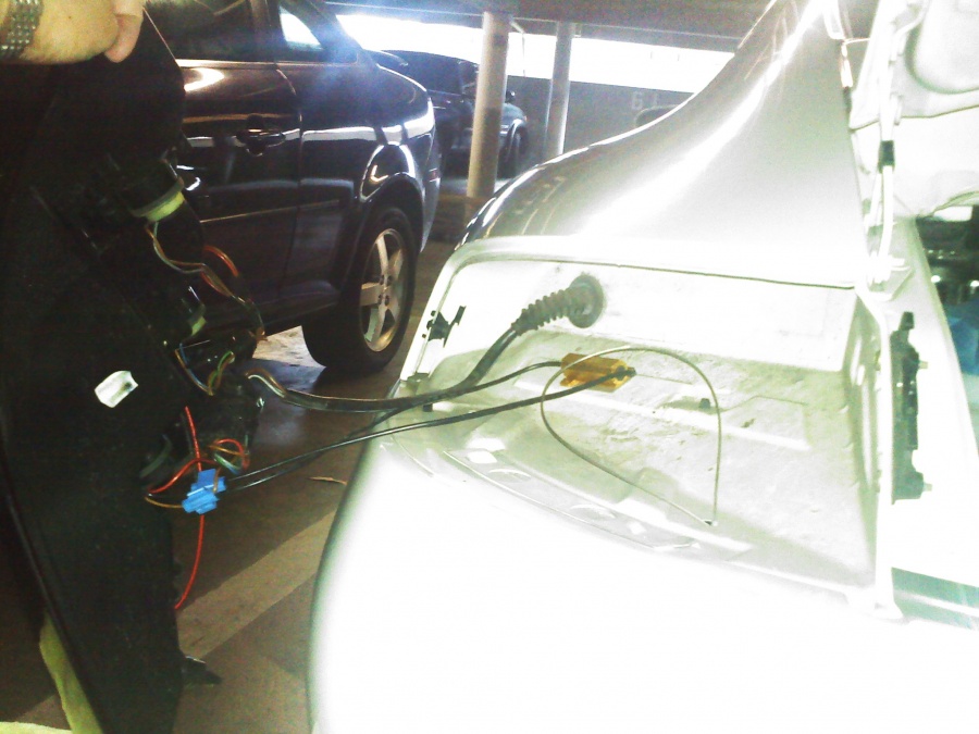

I just got a pair of resistors for the brake lights. I did not have the hyperflashing problem either. I did install LED 3rd brake lights as well as the LED taillights, I noticed that their was some voltage bleed through, because when the lights were turned off you could see that the LED's were dimly lit. Also, my cruise control light would come on when I first turned the key to the "On" position along with all the other lights on the bottom of the instrument cluster and went out just like normal. But when I tried turning on the cruise control after the car was running it would not come on. I read in other posts that you need to have some resistance in the circuit, just like the old incandescent bulds did for you to engage the cruise control. I installed one (1) resistor on the brake like circuit on each of the tail lights. This cured the problem of the voltage bleed through, "No more dimly lit 3rd brake light or marker lights on the tail lights" as well giving me back my cruis control.
Hope this helps.

Here is a bad picture that I took with my phone.
The resister is connected to the black and brown wires for the brake light.

I tried the LED flasher first. Didn't have the hyper flashing with the stock flasher relay or the LED flasher relay. I was hoping it would do the trick too. But ended up putting in the resistors. Not hard at all, just have to unscrew the retaining screw that holds the tail light assembly in place and splice two wires. They come with the wire splice connectors. Didn't want to drill any holes to mount the resistors so I used industrial strength double sided tape. Been holding them in place for 4 months without a problem. No evidence of heat degradation either.
