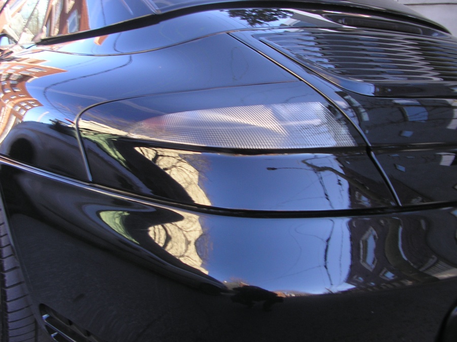

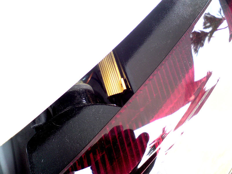

I've been looking high and low for led tail light for my C4S...still looking!
In the mean time I had to do something, so I blacked them out.
I have to say I love it!
Makes the car look wider and meaner.
Cheap but a lot of work.
Cheers,
Sid.

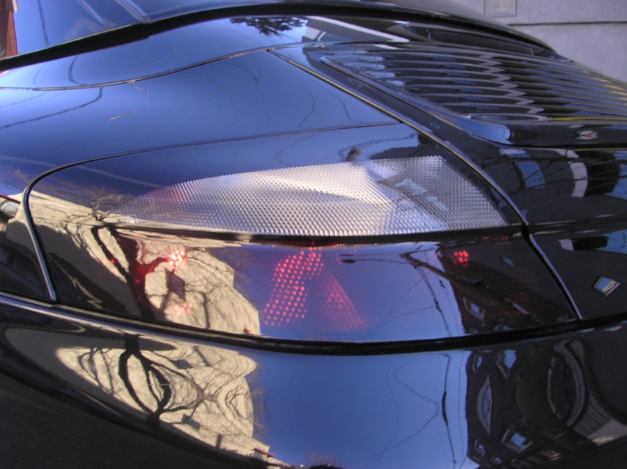

Okay, just a pic update on my smoked LED tails. And just to keep all pics and info in one thread, I decided not to make a new thread on this.
The smoked LED tails doesn't look as smoked as the LED 3rd brake lights. Sometimes, they doesn't look smoked at all (until a set of non-smoked is there for a comparison). However, on some angles and specially on any angles from afar and also at night, the smoked is very obvious. The closer you get, the less smoked these look. Sometimes, I'm thinking if I should use light-smoked LaminX to make them look a bit darker a bit, but I think it is better to leave them the way they are, otherwise, they're gonna look too dark from afar.
First, here is a side-by-side comparo of the OEM and LED, with OEM on top.
And here they are on my dirty car.

Oh yeah to answer a question posted to me here, the blackout on my taillights are not film I did it with VHT nite shade spay and Dupond acrylic clear coat, lots of it!

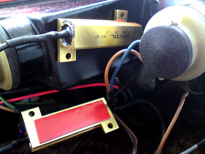

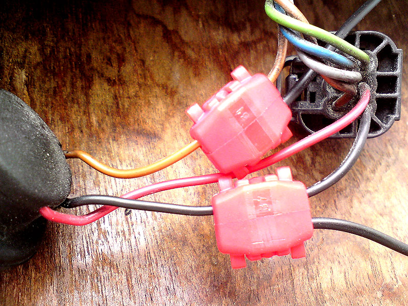

Cruise Control fixed!
Just completed the resistor mod and it fixed the cruise control! Thanks guys.
Attached are some pics of the DIY.
I bought Two 6 ohm 50W resistors from the electronics store at $3.50 each. A metre of 18AWG wire for $0.50 and Four T-connectors at $0.25 cents each. Add some heavy duty double sided tape and heat shrink tubing I had on hand, and soldering work, the total bill came up to only $8.50.

I wouldn't stick it on the light. I've been running resistors for my front leds for a while and they get extremely hot. I suggest you run a longer wire and attach it to some metal just in case.
i was going to say the same thing right now!!! these get very hot!!!!
