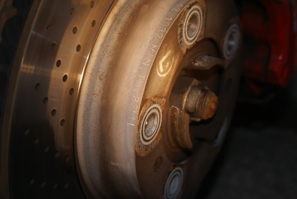

Thanks Artcollinsjr, after doing some digging on Renntech I found some additional info. On one of the 997 forums, I found a post that stated that the minimum rotor thickness is stamped on the rotor hat for the 997 models, and sure enough that applies on the 996 as well (at least for my '02 C4S). I also found a thread that stated that minimum rotor thickness should be 32mm front / 26mm rear and confirmed that with the stamps on my rotors, but I am sure there can be differences.
This is the front rotor on my car:
You can see where it is stamped Min. TH. 32MM. It was hard to make out at first, but I took a piece of chalk, rubbed the edge of the hat, and wiped it clean with my finger, the stamp stood out well enough to read and photograph after that.
Hopefully this will lead to less confussion in the future for anyone wanting to know minimum rotor thickness.
