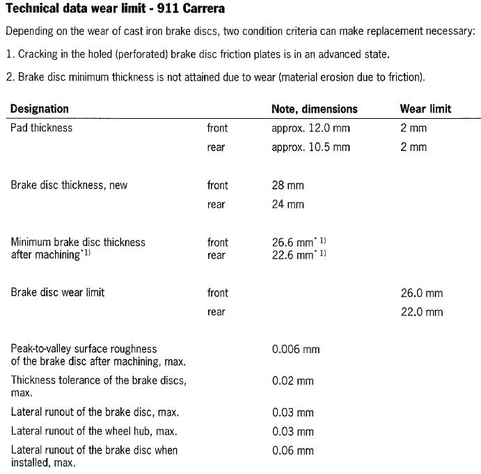

Yes. This is normal. Use a set of calipers and measure your rotor thickness. Brand new, rotors have thicknesses of: Front: 28mm Rear: 24mm. You noted 1-2mm of wear. This is getting close to the factory minimum wear limits of: Front 26mm / Rear 22mm.
Name:  BRAKE WEAR LIMITS.JPG

You *should* change the rotors every time you change the pads.
IMO, you should only change rotors when you need to based on wear limits or cracking (7mm cracks or connecting holes), or any other factors indicating unsafe conditions. Depending on the type of pads and your driving style (street, track, traffic, etc), you may go through 2 or 3 sets of pads to a set of rotors. The rears and fronts may wear differently as well.

You can always replace them to be on the safe side, but you should measure them before you throw them out, as you can always use them in a pinch if they still have life in them. It is not unheard of to only get 30K, but it is also likely that 30K is only 1/2 of your particular rotor life.
leading edge on the rotor ... are all level from center to the edge
Porsche rotors will not be level across the whole surface. The pads do NOT touch the entire rotor, which will result in a small lip on the outer edge. When you run your fingernail across the rotor and feel a pretty big lip, it is time to measure them.

You have wear limits as posted above. If you're under, don't replace them unless of other issues with cracking etc. If you replace them prior to the wear limits, you're wasting money. Germans hate two things, wastefulness and something else....oh yeah, anyone who hates Hasselhoff.

Ditto that man... Get a set of measuring calipers and check for yourself. My rotars are down at 25.1mm (fronts) at 36kmiles, 30 laps of the Nurburgring, and 'several' hard on the brake trackdays. I doubt your lip is as big as you estimate but measuring is a black & white science, just watch those cracks more than anything else.
