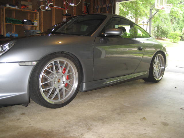

These 19's look terrible, don't they?

I have 245/35 up front and 275/30 in the back. When I get new tires in a few weeks I will reduce the width up front to 235 and increase the width in the back to either 285 or 295. Those tires came with the wheels.
I think the tire height will depend as much on how much lower than stock your car sits. One thing I like about 19's is the extra 1/2" of clearance means my car doesn't scrape nearly as often as it did with 18's.

What champion wheels are thos you posted, what is the diameter in the rear?
