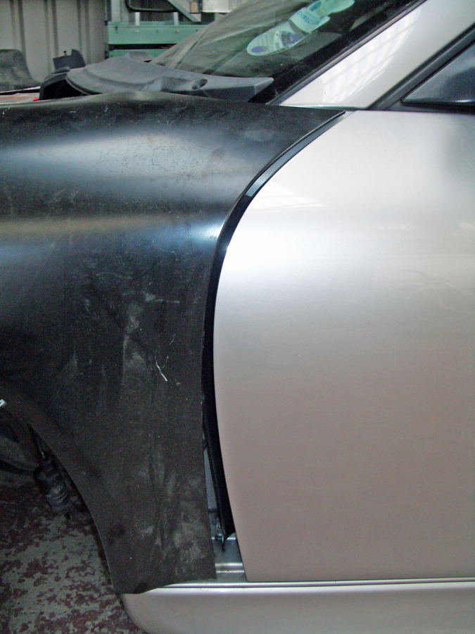

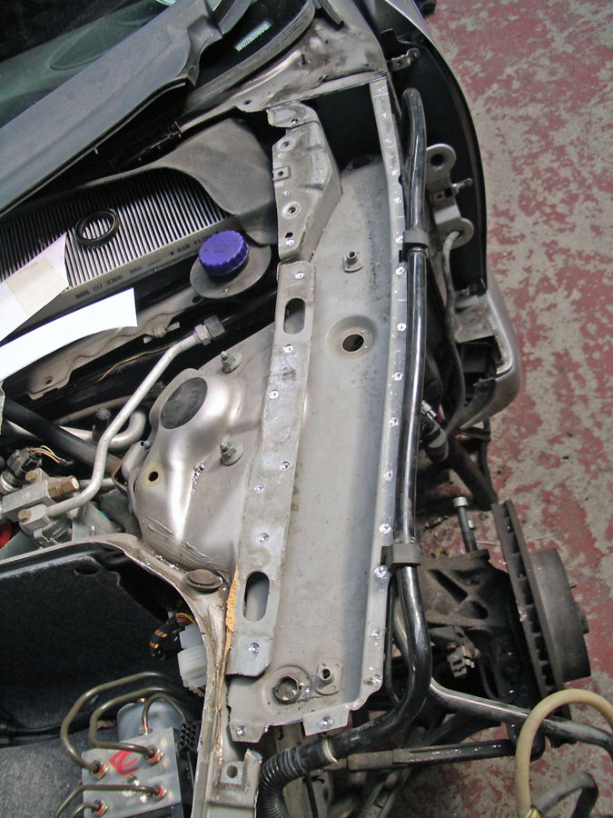

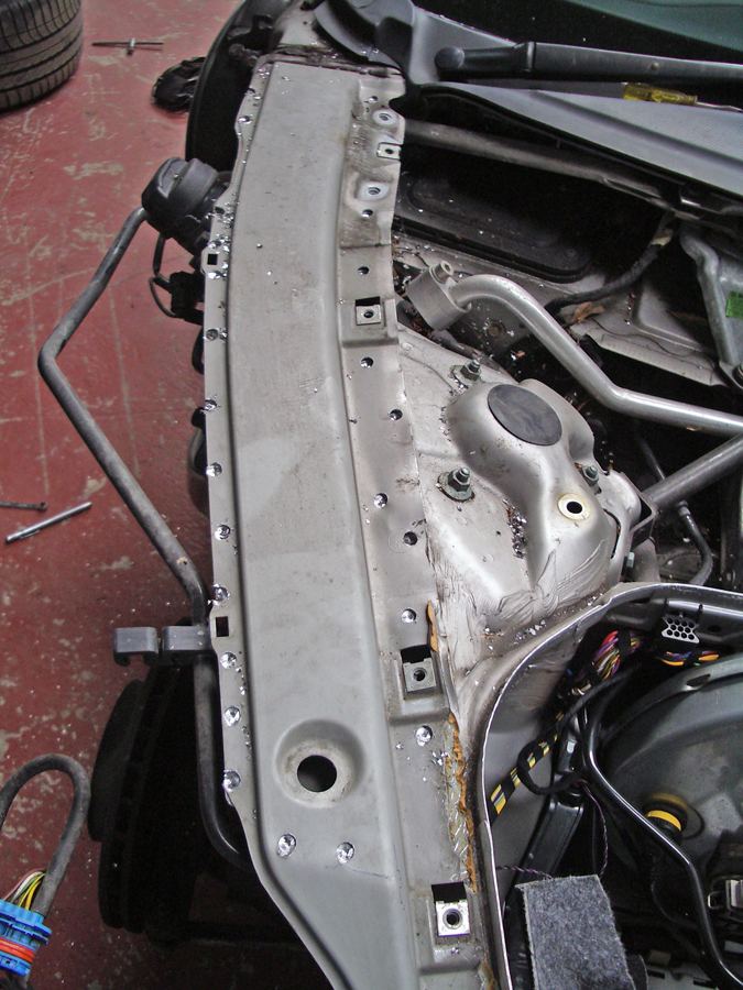

Once you have removed the fenders and you try to mount the 997 fender you soon come to the realisation that it won't even nearly fit and the fender sits way to high......the reason for this is because of the raised section of the inner wing shown in the first pic (the inner fender top panel on a 997 is basically flat!)........you need to drill out the spot wealds shown in pic and get your grinder out, be brave and chop that sucker off!

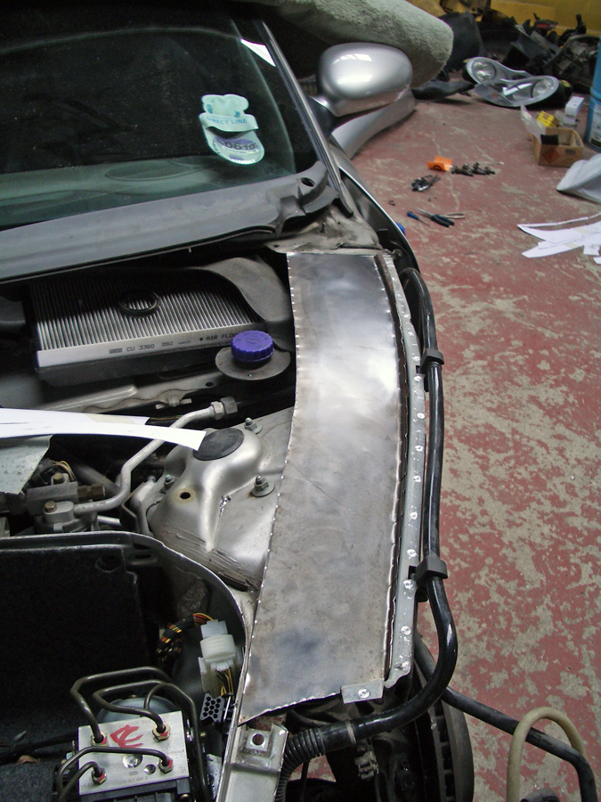

Once you have removed the inner fender top panel the inner fender top panel will look like the pic shown.......you then need to fabricate a sheet metal panel to fill the gap so the 997 fender can lay flat on the inner fender panel...pic shows first draft of panel.......this part was then trimmed and professionally wealded so the bonnet/hood hinge could be bolted on and also trimmed so once it is finished it looks as it would from the factory with brushed on seem sealer and a base coat of silver etc.
Now once you have done this you can get the 997 fender to sit correctly on the car.....you have to replace the 996 fender mounts with the 997 mounts which bolts straight on by the way.........the top line of the fender where it meets with the hood lines up ok but as you can see in the pic the door line and lower sill line is a country mile off!!!!
Well I hope this finally answers the million dollar question: "can you bolt a 997 fender straight onto a 996?"
To get the door line to fit requires you to get creative but I will cover this next time ;-)
