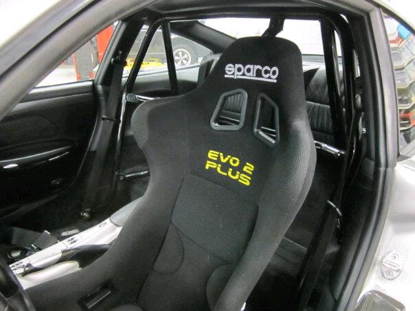

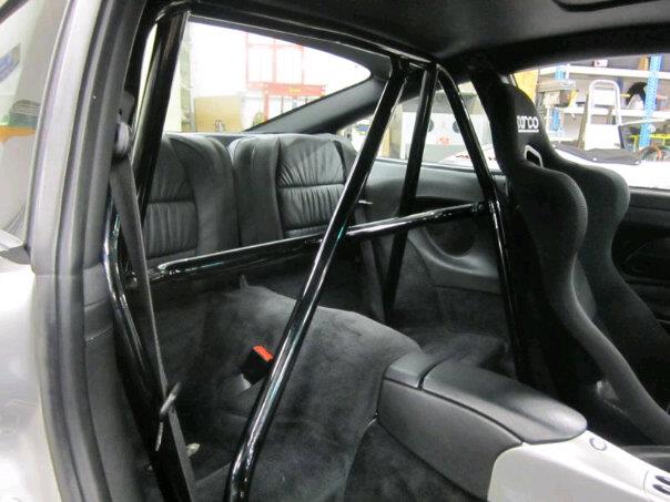

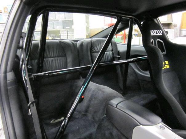

My Cage:
Seat flipped forward. Full shot of the cage:
Loss of leg room. Tight fit:
