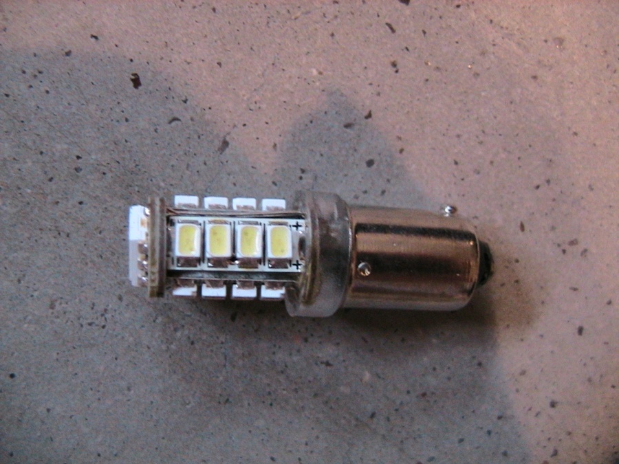

I've since found out that the US cars use the BA9S "straight pin" H6W, while the ROW cars (like mine) use the BAX9S "angled pin" H6W. This conlclusion is based on jr1966's experience and on checking my own car.
I hope this info will help those who are looking to upgrade or replace their driving lights.

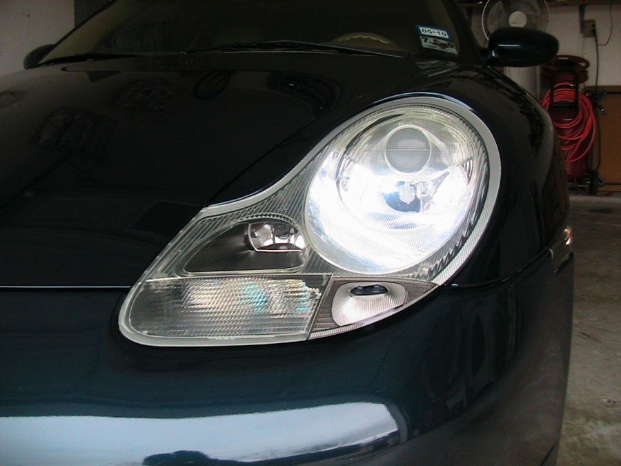

just got mine installed...and I have to say they do look much better than the halogen...Mine are the angle pins..I was also hesitant on de-amber my lenses...but I decided to bite the bullet and start probing away w/the soldering iron & out it come with the needle nose plier..costed me nothing and easiest mod I ever done..

yeh..It was cloudy when I took the pic..the bumper is MK1 aero..I removed the lower lip cause I'm tire of breaking it too many times.

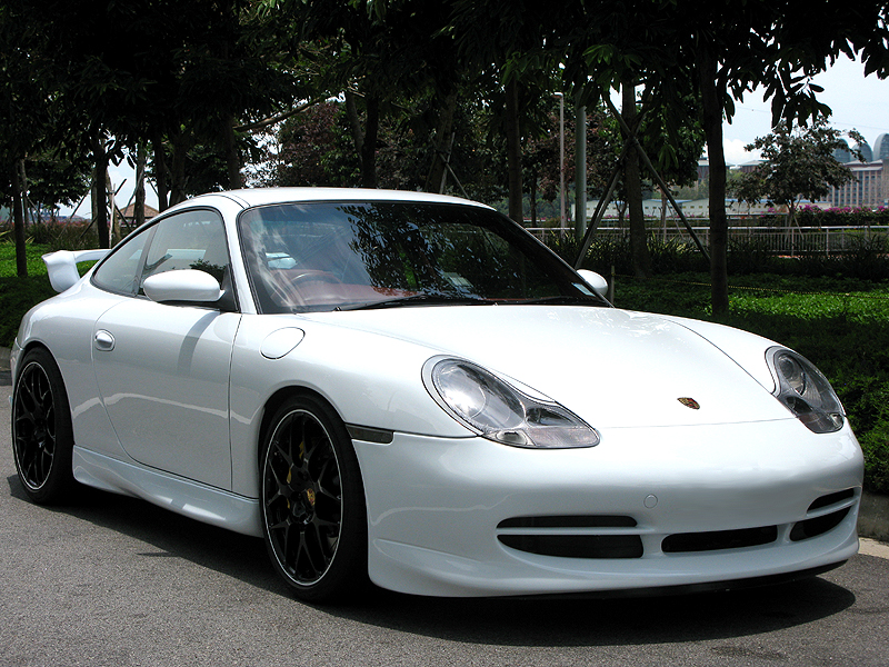

Wait a minute. I didn't really nuderstand the "Amberectomy" until I went through the DIY articles. I think mine have already been de-ambered. Can someone tell me if it has been done, based on my car pic?
can't see it that well from that angle..
if you remove the bulb out of the socket..do you see any amber lenses..if not than yours may have been removed..just switch out the orange bulb with the silver one.
from the way it looks, i kinda see some amber in there. it is either amberectomy had been performed but you just have amber bulbs or it is not yet performed. If it is the former, all you need to do is get some stealth bulbs in there. Stealth bulbs are silver in color but light up in amber. If you get the Sylvania Silverstars, you will get a bluish hue. With the stealth bulbs, you won't get the bluish hue. Stealth bulbs are available at stealthbulbs.com or ebay.

To you (and everyone else), please re-check my post above. The one with pictures. I made some corrections and I apologize for the misinformation. In trying to answer your question, I had to go back and found out my mistake.
Here's a link to where I had purchased these.
http://cgi.ebay.com/ebaymotors/2pcs-...ht_2357wt_1165
