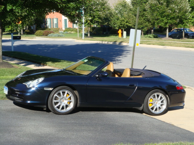

just did pss10s,h and r sways front and rear,front camber plates from tarret,and rear toe arm links also adjustable from tarret,and a 2004 gt3 euro-30mm drop alignment spec.but most important is finding some one who knows what there doing,when it comes to the install!,the alignment following the install is critical,and you will also need to follow up with an alignment check,as the suspension will settle after a month or so.you can then also adjust the damping feel and ride height,what can i say absolutely incredible!the car feels like its on rails,almost feels like a new car,sits lower and feels so planted,not sure what damper settings im gonna stick with for the street,right now 5 front 7 rear,ride comfort doesnt seem that compromised from stock at these settings,will report further in future posts,now dont get me wrong all these upgrades werent cheap,but i think coilovers wether bilstein,kw(even more expensive)h and r or any of the other companys with porsche fitments may be the best upgrade,next to a b and m short shift kit,so start saving you wont regret it!....thanks go out to jay and the boys at EXOTIC MOTOR WERKS in plainview long island,new york,what a shop! state of the art everything,i got to watch jay work,absolute perfectionist and a real gentleman with the credentials to back it all up,porsche trained tech going back many years,here on long island,i want to wish jay good luck with this new business!

Yea sorry !i was considering the row mo30,and i talked to quite a few people and they suggested some alternatives.i guess i got a little carried away!sorry bout that...
