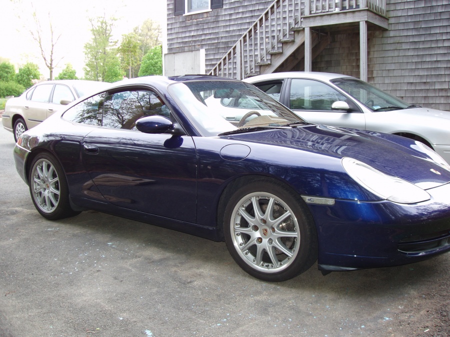

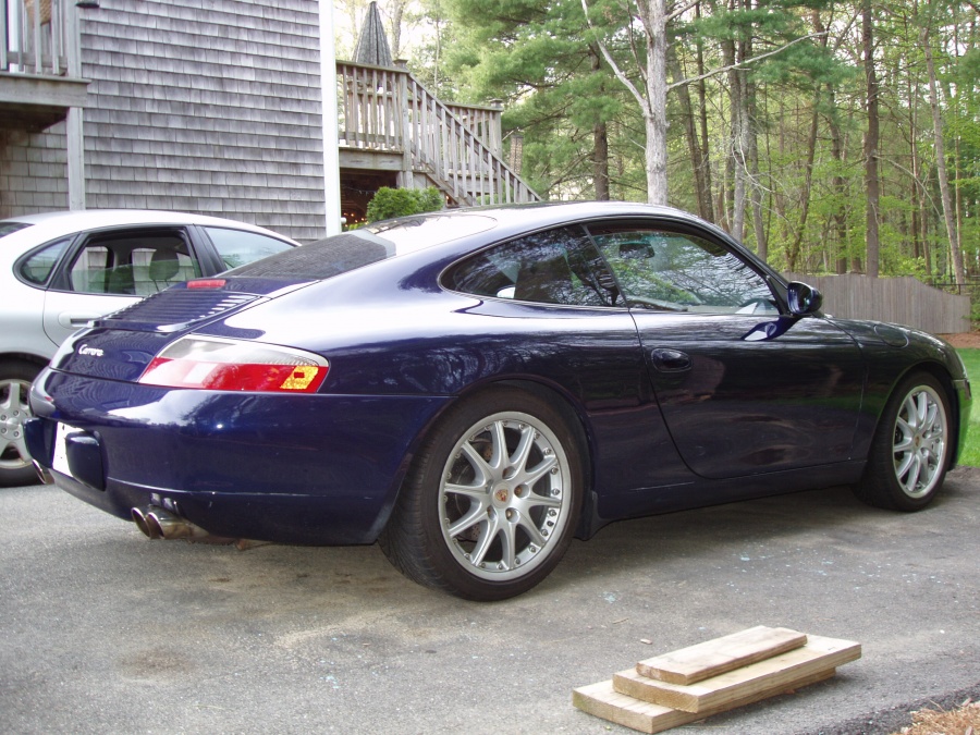

Just finished a thirty mile test drive with the M030 just installed.

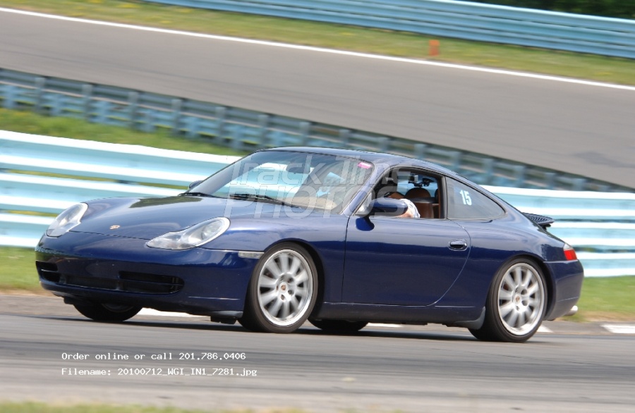

That was the entire kit, shocks, springs sways and bushings. The rear sway is thicker than stock, the front is the same stock part. I cannot confirm if this kit is the same for an '02. When I called sunset, I asked for Porsche parts and got the next guy available. They are very conscientious and professional there. I have spoken with several different people there and have nothing but good things to say about all of them. This is a good DIY for a person with the right tools available, not hard or complicated at all. I have attached some more pics from the Glen last summer. It shows the suspension loaded differently on various parts of the course.
