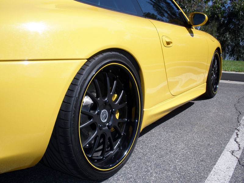

Rear wheel offsets
1. 18 x 11 with 55
2. 19 x 11.5 with 62
3. 19 x 12, no offset info.

Originally Posted by jmla
1. 18 x 11 with 55
Nice wheel/tire combo, what size wheels on the black cars.

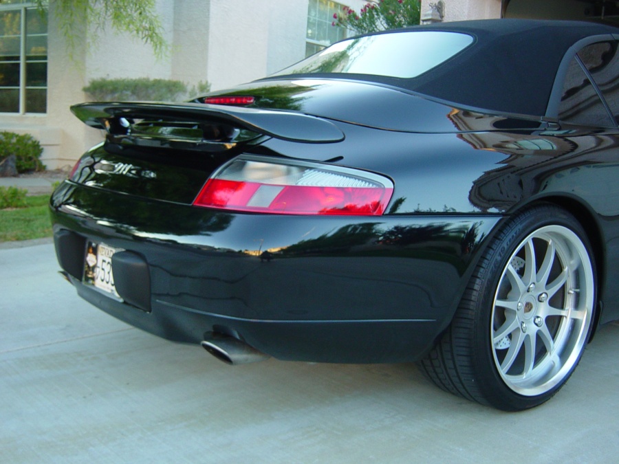

Any additional pics of this example on a NB?

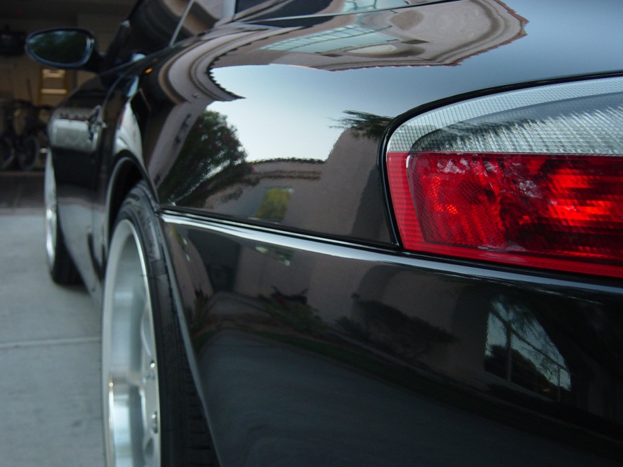

This is the only other one that I could find.

jmla,
Nice setup!
Wheel Brand?
Tire Size on Rear? Front?
Is the Wing a Betterbodies?
Old Apr 15, 2010 | 10:13 PM
jmla's Avatar
Joined: Jun 2007
Posts: 341
From: West Hollywood, CA
Rep Power: 36
jmla is just really nicejmla is just really nicejmla is just really nicejmla is just really nicejmla is just really nice
It's not mine, but those are Kinesis F110.
