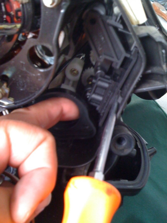

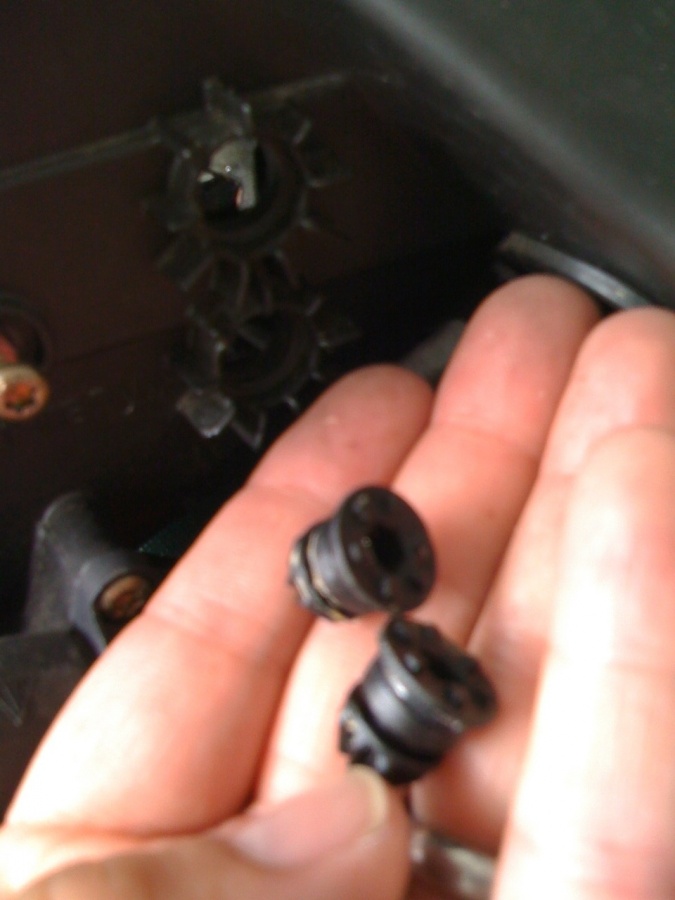

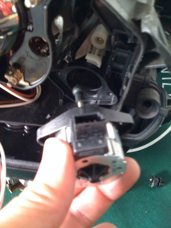

Here's how i did it
1. Take out the headlight using the removal tool in your tool pouch.
2. remove the black cover on the back, 2 screws next to 2 clips and undo it.
3. I only unplugged the wire to the little self leveler, and pulled all the wires out of the little clip that holds it in the middle
4. unplug the self leveler, and remove it by taking the 2 torque screws off, and then angle it out of the track, 1st picture.
5. in the 2nd picture below, there's 1 screw on the side that faces into the center of the car. Remove that with the torque driver.
6. in the next picture, you'll see that I pried and pulled, see the points I used to do this, and that whole black piece comes out giving you enough room to do what you need to do in there. Note that the 2 dots came out when i pulled the unit out, 4th picture. Just remember that when you put it back, these dots go in the same way, slide the unit almost all the way in, then put dots in, and then finish pushing the unit back into place. I didn't need to pull the entire thing apart, as I found that mine was not broken, and just fell out of the tracks. I did however notice, that if you wanted to take the thing apart, there are 4 torque screws at the bottom part of the internals which are bolted to the silver back parts of the internal, if you remove those 4 screws with a little finesse, you could take the whole thing out and apart.
7. All I did was pop it all back together and all was good.
Good luck man.

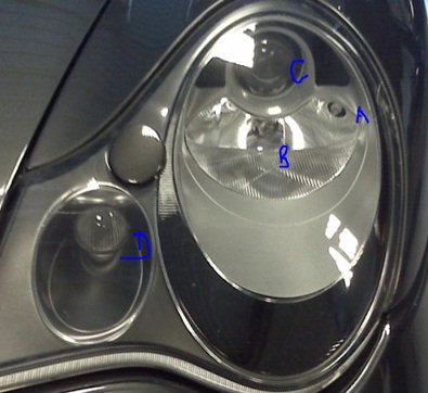

Question
dave, actually the bulb on the side of the lens is the one that is dim, is that the main headlight bulb, when i put the brights on, then the bulb in the middle came on, & i noticed neither of the bulbs on the inside of the lens came on, inside i mean the 2 seperate small lens closest to the trunk, do you understand what i'm TRYIN to say.
Old Jul 19, 2010 | 03:31 PM
davebho's Avatar
Joined: Apr 2010
Posts: 89
From: california
davebho is infamous around these parts
Johnny, you've successfully confused me
OK, since your a picture guy, here goes. See picture.
A=parking lamp, it is dim in nature, and stays that way
B=signal light, left/right, hazard, alarm arm/disarm
C=headlight, I have a bi-xenon. What that means is if it's on, and i hit the highbeam, something inside the projector deflects the lamp upwards or in normal mode just shines strait out
D=highbeam, this only comes on if my headlights are off, and I just flash the high beams.
Now, if your lights behave the way I've noted above, it's normal
