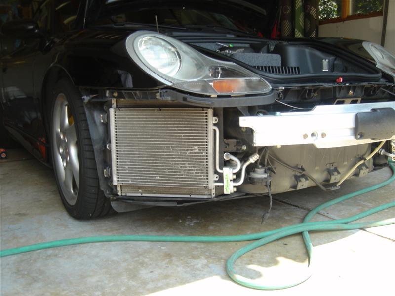

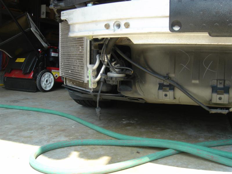

Chris, I have my front bumper off right now. I can see the two OEM horns. I can take any measurements you like. From the space I have seen, there seems to be plenty of room to fit the air horns or others in there. BTW, the horns are located on the right side of the trunk compartment (or bonnet if you like) not in the wheel wells; and there is an equal amount of empty space on the left side of the trunk if you want to mount another horn on that side. I'll take pics with a ruler in place if you like. Just let me know.

Thanks for the quick reply and offer of help - I really appreciate it. I don't want to make this more complicated or difficult than it needs to be, and I should have been more precise in what I wrote. I've been told that the horns are on the right side of the car (i.e. the passenger side), behind the wheel well liner and I would assume next to the trunk. It sounds like that's exactly what you're describing. I'm sure that pictures and measurements would assist me. I guess the question that I still have is, do I need to remove the bumper to get in there, or can I (as my mechanic told me) access the horns by removing the right front wheel and the wheel well liner, or (based on what you're describing) is there a way to access them through the trunk? If I have to remove the bumper, how big a project is that (without a shop manual)? (I'm an average shade tree mechanic with a pretty good set of tools . . . ) And do you know what another poster was referring to when he advised removing the "skid plate?"

I wouldn't try to access them through the trunk as it is a fully metal encased structure with no access to the horns without cutting through I guess. I think removing the bumper is the best and easiest way to go because doing so provides you complete access. Additionally, you can get in there and clean out the radiators now and then which you'll have to do at some point - might as well learn how to do it now. Is is possible to access the horns through another route? - I don't know, maybe; anything is possible - I wouldn't do it. Anyway, I'll leave that to you. Here are the pics you requested.
