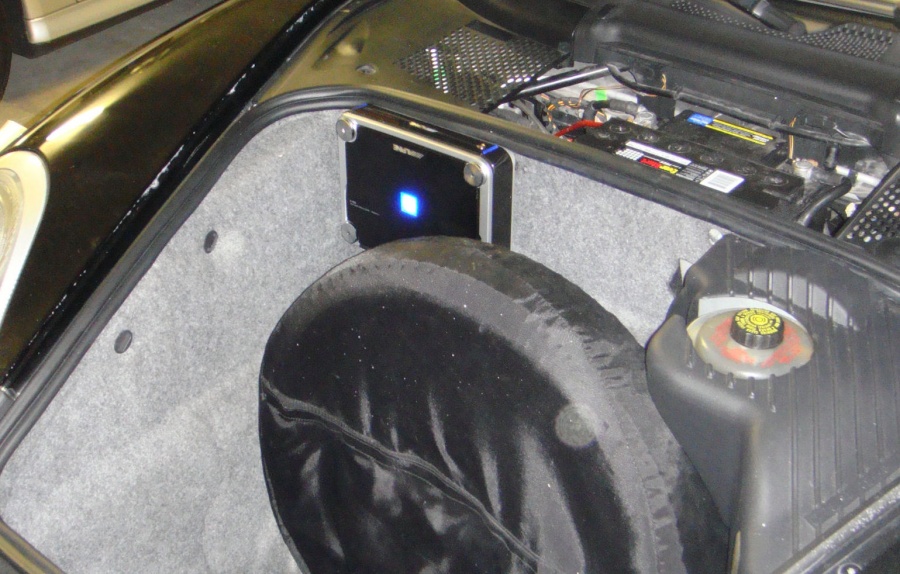

Sorry, my misunderstanding. In my cse I got an adaptor from Becker that allowed me to run RCA cable from the OEM head unit low level outputs to the new amp. You can see the adaptor here
http://www.beckerautosound.com/parts/index_porsche.html
Ran two sets, one of which included an extra wire for the power antennae lead from the head unit which is used to control the power to the amp. With this set up I am able to use the balance and fader from the head unit.

There's two adapters you can get to make it easier. 1 is the plug that handles power,ground, illumination, etc. the other is a separate piece for the RCA's.
I tihink I paid under $30 for both IIRC. You can just use the Metra line of connectors for Audi's since they are the same and more readily available. I don't have part numbers off hand but I'll try to upload a couple pics tonight.
Forget if you need an antenna adaptor too(I think so).
