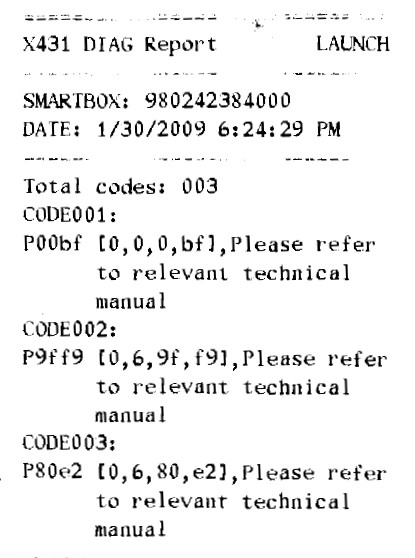

Car was parked for a few weeks, started it up and its got really rough idle and doesn't rev above 3000rpm, the pedal feels like it has no power. CEL comes on and after a few mins the engine stalls. can't start it back up. the Engine turns and tries fire up but it seems like either no fuel to the engine or thinking air mass sensor went bad. I got 3 codes from the reader but can't find what they mean anywhere. about a month ago I encountered problems with hard acceleration which the car will hesitate if you floor the pedal but if you slowly gas it, the car revs up fine. Any ideas?

thanks guys. I have the codes but not having much luck seeing what they mean, its not on the internet anywhere, the dealer treats them like top secret info and just tells me to bring the car in. that will be my last option but before I do that, I just wanted to see what the codes mean and see if I can fix it first. these are the 3 codes, ( p9ff9 , p00bf , p80e2 ) I was able to find p00bf on internet, it says " Mass or Volume Air Flow "B" Circuit Range/Performance - Air Flow Too High "

register on renntech and try to go here
http://www.renntech.org/forums/index.php?app=pcode
then under 'DIY Menu' there is a choice 'ODBII codes' - try to search there.
in decimal
00BF is 191
9FF9 is 40953
80E2 is 32994
or you may need to work with last part of those codes (bf, f9, e2) only, nopt sure - there is an older article with same thing here:
http://www.ppbb.com/phorum/read.php?...92#msg-1466992
