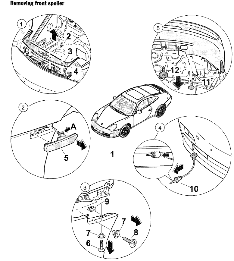

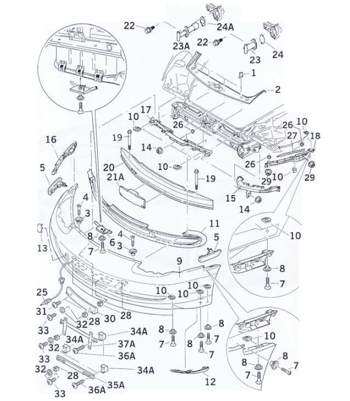

Originally Posted by Guybrush
Somebody reversed his car against the front bumper of my 996 and hit it with a towing hook yesterday on a parking lot. The bumper needs to be removed and painted. I just got back from an auto body shop and the painter asked if I had an "explosion picture" of the front of the car to help him remove the bumper. I dont, but maybe someone here has one?
Here's the blowup. But the bumper comes off with just a few screws. It's pretty simple.
Here's the how to.
http://www.skylersrants.com/Porsche/.../Radiator.html
