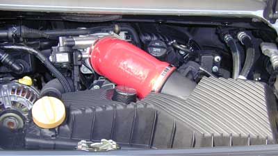

Do you mean this?

Originally Posted by Nine_Eleven
Yes I am talking about eliminating the "air box muffler" that's located inside the air box. And blocking off the small elbow pipe that's connected to the big elbow intake pipe. It adds 1.5 Liters cold air by eliminating muffler in airbox. This allows engine to draw cold air across entire topside of air box (left and right rather than just from the right).42 seconds faster acceleration 3000-6000 RPM. 4 ply silicone tube - better flow from airbox to throttle body. No C.E.L. light as you retain the factory MAF plastic screen/grill to straighten out airflow. 25% better Airflow = More Power
They have instructions and pics on the DIY section at Renntech.org

I understand about removing the resonator and adding the 2 inch pvc. The part that I don't understand is that he says he puts a rubber cap on the PVC, but doesn't explain what to do the the smaller hose that comes off the main hose. I also don't understand how the factory setup works, so I would be reluctant to mess with it until I did.

Two ways
1. leave the factory hose and block off the small opening
2. Get a new silicone hose for the larger opening and cap off the small opening
You can plug the small opening and put the small hose back on, it will not work since it is blocked underneath.

You also have to remove the air box muffler for more air capacity.
