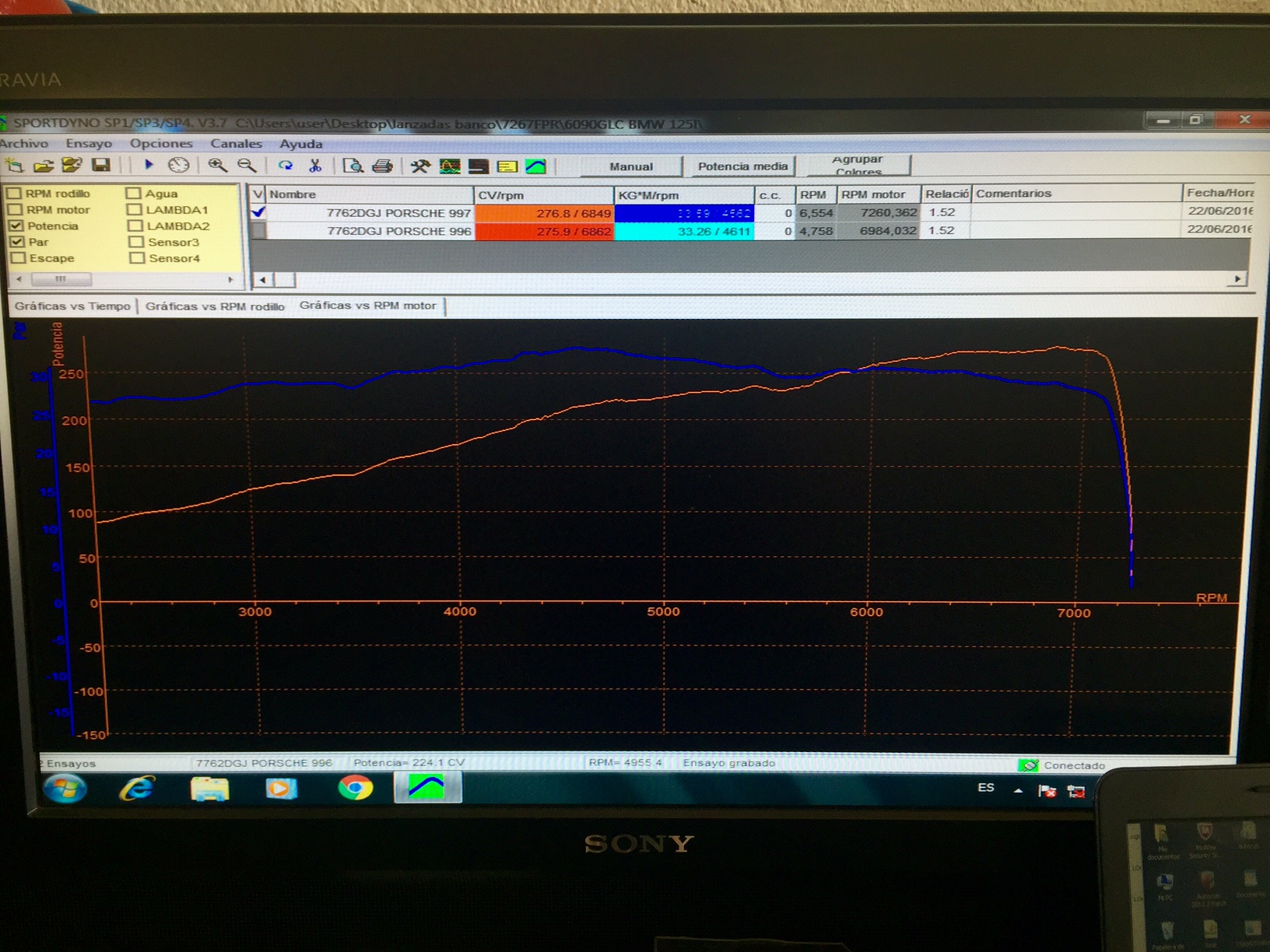

I'm facing aparently a similar issue, but not sure it's the MAF.
I was to reflash my 996 C2 (MY2000) and first found max power was at 277 hp instead of the expected over 300 (bypass, gt3 throttle body, ipd plenum, bmc air filter...).
Then the guy checking the numbers found too lean mix at higher rpm which I did not expect as car was running perfect IMO. Anyhow we postponed the reflash till the lean issue was solved.
See the dyno bellow:
[IMG]Click image for larger version
SInce this test last week I've clean the MAF, checked for leakages and read a LOT of posts about it but still could not get a clear idea. Since I have a durametric cable I did a couple tests on 3rd gear WOT a recorded the following parameters:
1-RPM
2-Mass air flow (MAF)
3-Adaption, range 2 (FRA), bank 1
4-Adaption, range 1 (RKAT), bank 1
5-O2 sensor voltage ahead of cat. conv., bank 1
6-Adaption, range 2 (FRA), bank 2
7-Adaption, range 1 (RKAT), bank 2
8-O2 sensor voltage ahead of cat. conv., bank 2
1 2 3 4 5 6 7 8
1.681 160 1,02 -0,19 0,84 1 -0,52 0,87
1.928 188 1,02 -0,19 0,88 1 -0,52 0,88
2.176 221 1,02 -0,19 0,86 1 -0,52 0,87
2.418 237 1,02 -0,19 0,88 1 -0,52 0,88
2.673 244 1 -0,19 0,88 1 -0,52 0,89
2.921 295 1 -0,19 0,88 1 -0,52 0,87
3.156 323 1 -0,19 0,87 1 -0,52 0,86
3.400 342 1 -0,19 0,88 1 -0,52 0,88
3.679 390 1 -0,19 0,87 1 -0,52 0,87
3.985 437 1 -0,19 0,87 1 -0,52 0,88
4.253 468 1 -0,19 0,87 1 -0,52 0,87
4.539 516 1 -0,19 0,87 1 -0,52 0,86
4.816 561 1 -0,19 0,86 1 -0,52 0,86
5.104 589 1 -0,19 0,85 1 -0,52 0,85
5.424 624 1 -0,19 0,84 1 -0,52 0,84
5.697 667 1 -0,19 0,84 1 -0,52 0,83
5.988 695 1 -0,19 0,83 1 -0,52 0,83
6.286 680 1 -0,19 0,81 1 -0,52 0,81
6.565 704 1 -0,19 0,81 1 -0,52 0,76
6.857 764 1 -0,19 0,83 1 -0,52 0,82
7.056 784 1 -0,19 0,85 1 -0,52 0,83
7.306 643 1 -0,19 0,84 1 -0,52 0,81
Any clues?
Thanks in advance

Just as a FYI, you will NEVER reach 300whp on a 3.4 with just those mods. 277whp is a very healthy and realistic figure for a 3.4L.
You got a chart for your af graph?
Old Jun 28, 2016 | 02:36 PM
xabi_one's Avatar
Joined: Jun 2016
Posts: 6
From: Spain
xabi_one is infamous around these parts
Thanks Alpine for your answer.
I also thought 277 hp were OK, but note they're corrected figures at the crank and not on the wheels, so I guess a typical 15% is added to real numbers.
About the MAF I did use almost half of the cleaning spray but have to say the liquid was falling of very clean, and didn't feel any improvement.
On the other hand I've been doing some work with the previously showed data and the MAF vs RPM graph under 3rg gear aceleration looks like this:
How about the MAF gap at 6000 rpm? Could it be the variocam effect or something is looking bad with MAF or airflow?
Thanks all for your help

Sometimes it doesn't matter if you clean the MAF. An old MAF may be distorted from contamination and and worn out. I had cleaned the MAF on my car and felt I had gotten back a lot of hp and then for kicks I ordered a new MAF and voila - 15 extra hp appeared!!!
Old Jun 29, 2016 | 07:26 AM
alpine003's Avatar
Joined: Mar 2010
Posts: 2,004
From: Chicago
Rep Power: 122
X2. This is a good possibility too. I would either try to borrow another local members or just plunk down the cash for a new one. IIRC, you can get a bosch one for around $100.
6k is too late for Variocam switchover and signs do point towards a MAF issue.
Also make sure you had a chance for car to adapt to new mods with new adaptation values. When I first put on those mods, I got beat by a Audi A5 and my car didn't feel like it wanted to rev all the way up.
As a FYI, ~265whp seems to be the avg on a dynojet for a 3.4L
Old Jun 30, 2016 | 02:49 PM
xabi_one's Avatar
Joined: Jun 2016
Posts: 6
From: Spain
New MAF on its way. Closer to 200€ than 100€ but still less than half compared to OD. Hope for the best.
I'll keep you updated and thanks for the good tips!
