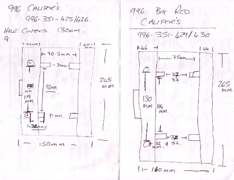

Old Jan 10, 2011 | 12:51 PM
ALE-SUPERBIKE's Avatar
Joined: Feb 2010
Posts: 224
From: italia
ALE-SUPERBIKE is infamous around these parts
These calipers front in comparison:
