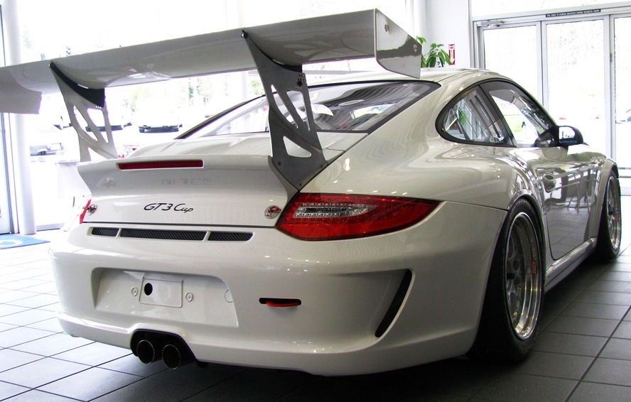

Hey! That is our car! Just fiddled with the just installed Porsche throttle blipper on monday at the track.
We had the new 2011 car on display on the weekend, here are a couple of pics.
