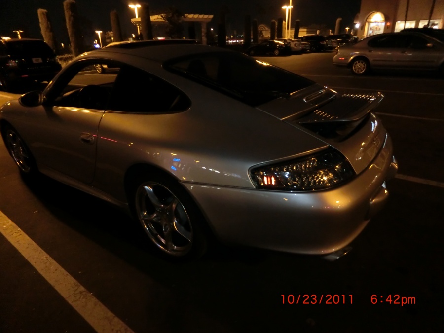

It fits, thanks @balefire. I just had to order special fitment red bulbs to color the smoker. Thanks guys, I found out it was a simple switch, since the harness was a whole unit, no splicing, cutting or re-wiring was needed, just a little ingenuity. lol.

Hello! I am installing these same lights later this week... Would you mind putting a picture of your car with these lights up?
