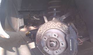

Take out the rear tires.
Once you do you will see a cover with 2 10 mm bolts, take that out and it will expose 3 spark plugs per side. There are 2 #5 hex bolts per coil packs. Remove those and pull out the spark plug and tubes. Use a standard spark plug too with 2 3" inch extensions or if you have a 4" extention with the 3/8 socket tool you should be fine. Its gonna get a little tight towards the exhaust. Make sure not to drop any extentions down the hole, pain to get out. To take off the coil pack from the tubes, squeeze the side of it and it should pop out. Use some anti freeze on the new plugs that you put in, once you put back the plugs torque the plugs to 25 lbs if you can. I also used a can of quick dry to clean the connectors of the coil packs. and re assemble. Good Luck Hope this write up helps.

Size:  8.0 KB rear wheels take off.
