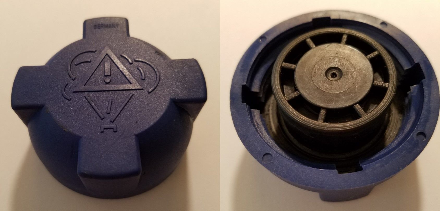

Pump, thermostat (low temp) and belt are definitely on the to-do list. The expansion tank looks brand new (bright white) and the cap is the new blue one. See attached photos. No part number on it however. Says 'Germany' on it. A clone perhaps?

I would go with the genuine Porsche cap (blue, ending in 04). Someone on another forum had a problem with an aftermarket cap.

So a real Porsche part would have the part number on it? This one, although bright blue, has no part number on it.

Here is the latest Porsche cap.

At this point we can't tell if the cap is the problem, but you can eliminate one variable by putting on the proper cap.

New Porsche Expansion Installed
Made the drive of 20 miles to local Porsche dealer and bought a proper cap, with part number molded in. Wasn't sure I was going to make it all the way to the dealer because the low coolant light went on just before I got there. The expansion tank was on the Max lone when I started. Interesting that the temp fell from over the right edge of the '0' in stop-and-go traffic to between the '8' and '0' on the temp gauge while driving at 60+ mph on the expressway. Drove all the way back with light still on. Will now let it cool down so that I can top it up and put on the new cap. I am eager to see how it behaves ... hopefully some improvement and proof it was only the cap leaking.
