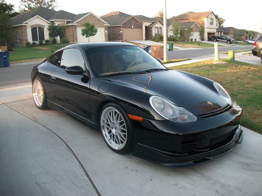

What do you guys think? The old "boxter" front bumper just wasn't for me. I gotta say that i needed to do a little more custom fitting and shaving for a Saturday afternoon than i planned, but it was well worth the hard work.
Tony... you are the man!! thanks bro!

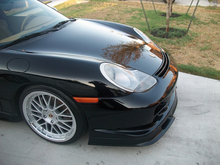

If you're familiar with the bumper piece hidden under the hood cover, this is "sandwiched" in a bracket held with one screw on each corner. The fiberglass was too thick to slide in this bracket and i had to shave down the entire lip. In addition, when i finally got it to slide in, if i set it all the way back to srew it in the factory holes, the hood layed on top of the bumper. With this, I had to slide the bumper out o the factory bracket, and drill new holes in both the new bumber and bracket to fit properly.
On the corners where the side markers sit, this was bilt up extremely high and i had to use a dremel tool to shape this for the markers to fit at all. After making the signals fit, i was not able to se the corner screw to secure the mmper to the car as the material was too thin at this point to hold a load and didn't want to chance breaking the piece of that holds the light. So i had to be creative in secring the bumper to the existing fiberglass panel on the chassis of the car.
Theoverall fitment is great and i'd definately buy more products. I just wasn't expecting this many modiications to the actual car itself.
