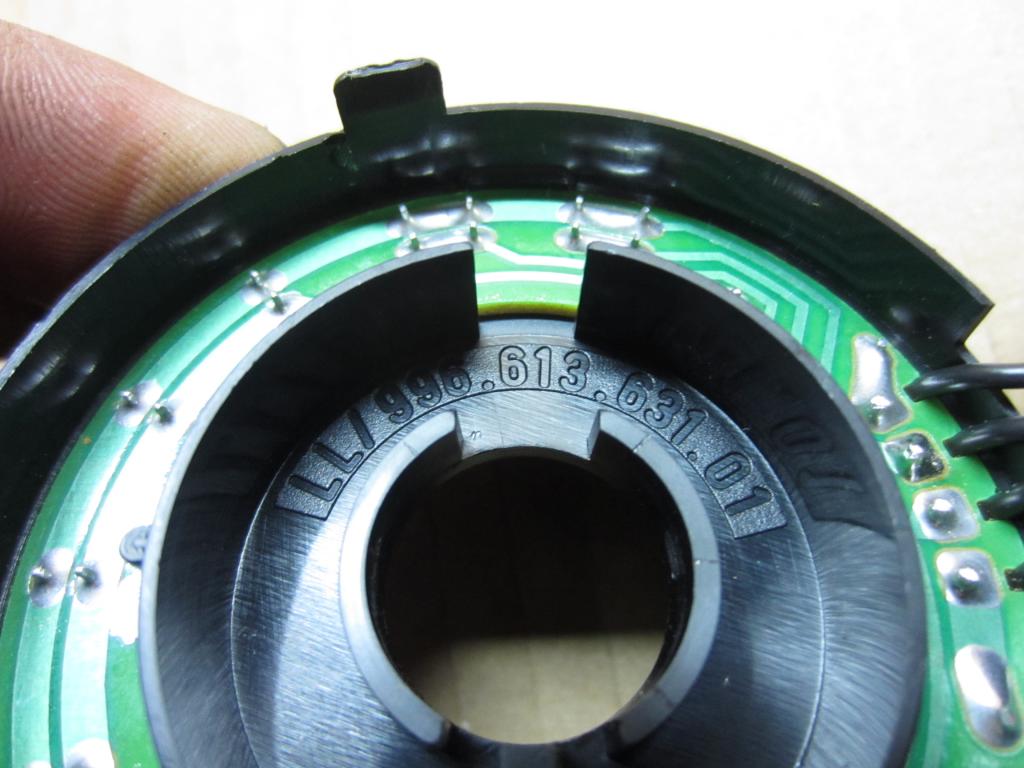

Just to be really sure :-) which of these do you actually spray the electronics cleaner on? I don't want to short out anything.
Do you spray and clean this...
or this...
or this...?
OR, is it something else and not in any of my pix?
Thanks again!
or this...?
Thanks again!
This. Both sides, especially the center hole on the other side so that it can get inside of the switch. Turn the **** a multiple times to get the cleaning fluid all around the contacts inside and let the switch drain/dry before reattaching it.

Just to update the thread. Yes the electronic cleaner worked!! :-) its like new and headlights now turn on immediately. No flickers and no delays! Thanks all.
