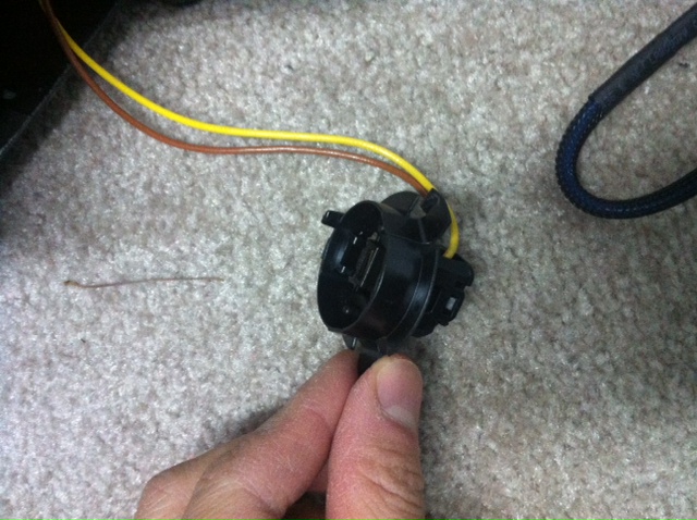

Photo 1 is the stock bulb in OEM socket.
In picture 2 is the picture of the HID bulb VS Halogen bulb in the socket.
Pict 3 is when the HID bulb is inserted into the assembly, but I have no way to secure it, since the socket the bulb was attached to would not fit here.
Pict 4 Is the socket that actually holds the bulb there.
I am not sure if I can somehow modify this socket to use as a holder. Alot of cars have a spring loaded clip to hold the bulb to the assembly, but looks like the 996 does not and have a specific socket the bulb is inserted into and then screwed onto the assembly.

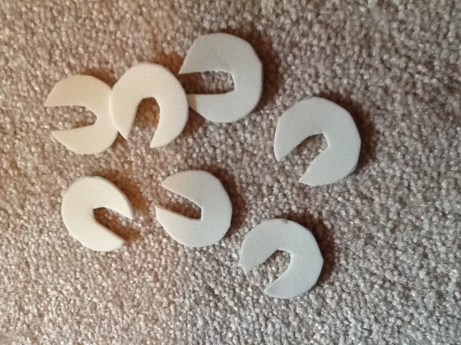

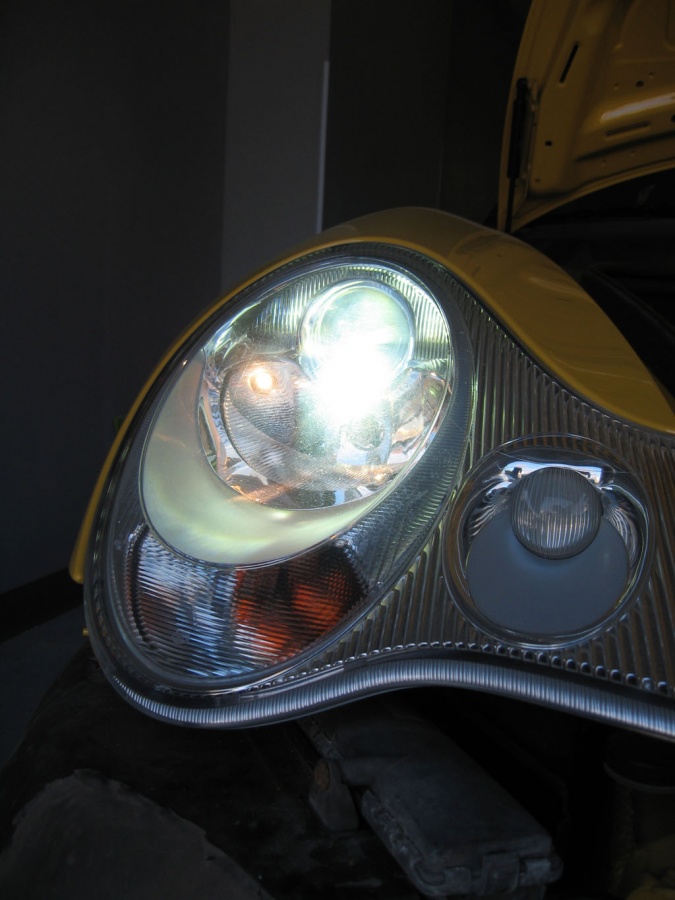

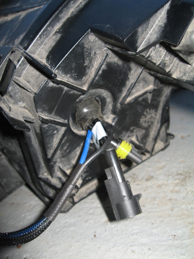

Ok, I decided to retrofit the kit today. I used some foam pad I had, cut out a U shape piece, about 7 of them per bulb. Then used a thing wire to wrap around each tabs on the side to hold the bulb into the socket. It's solid, no movement at all. I do not want to destroy the socket and this is completely reversible.
I then had to drilled a small hole in the back panel to feed all the wires through, with ballast mounted on the frame of the car with double sided tape. The ballast and all the wires would not go fit inside the assembly.
