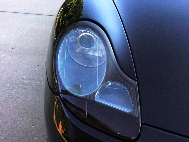

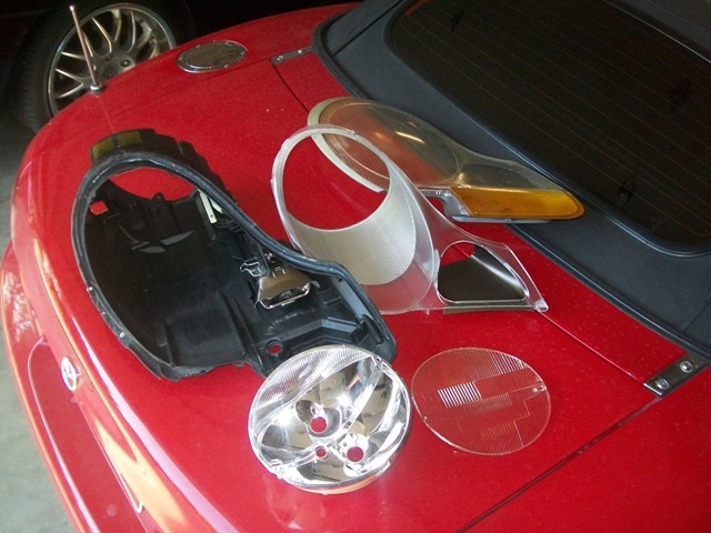

Here is:
Morimoto Bi-Xenon kit
Headlight assembly in parts - note lens that won't be used
Bi-Xenon installed in headlight reflector - note lens cover in background
Final result

Damn 15psi you went all out on doing those headlights. What did you use to black out the bottom of the headlights?

This is my second version. The first time I used the VHT tinting paint that you get at auto part stores. It was chipping within weeks. After 6 months, I stripped it off and used 3M automotive paint materials that I used to paint my spoiler. I used '2 part urethane' clear coat and added a FEW drops of the black paint to tint it. Sprayed a few coats with HVLP gun. A few extra on the amber lens. A year later it is great.

Did you spray it on the inside while the lenses were apart?
