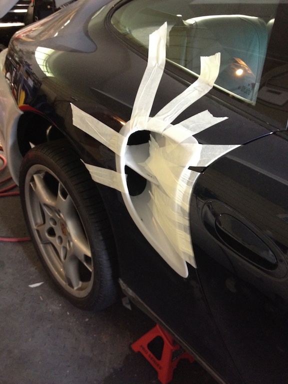

I used an air powered cutoff wheel like this: http://www.alltradetools.com/catalog...utoff-tool.jpg
As the template was a little smaller than needed, I had to use a grinder to expand the hole as necessary to make it fit nice.
If you use a grinder, you have to hold it very firm in your hands. If you aren't holding it firmly, it will bounce and can catch the metal making a bit of a bend in the metal. No big deal, you just pull it back in with pliers, but... just better not to deal with it.
Also, watch the heat with a grinder. It can heat up the metal quickly and it can also take off a lot of material quickly. If it gets too hot you can cause warpage in the quarter, that is bad news bears. Just use it for small adjustments and take your time.
Test fit, test fit, test fit, prior to epoxy. What I did was test fit it, then made some marks with a felt pen so I knew where the right alignment was. I used a metal sanding wheel to get the paint off for bonding, but of course below the alignment marks. Then you'll also want to use tape to hold it tightly in place. I also ended up using magnets for vinyl wrap on the tap so it stayed holding the duct tight to the body.

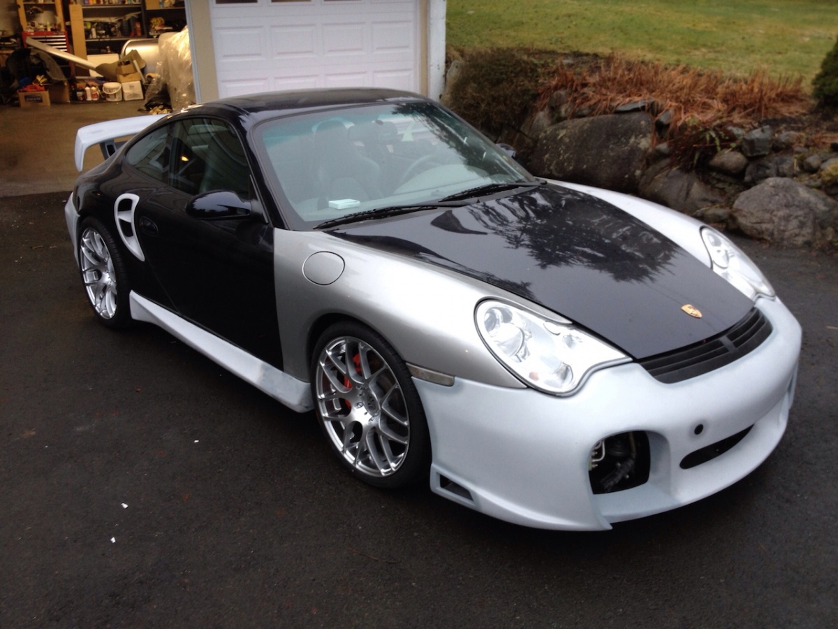

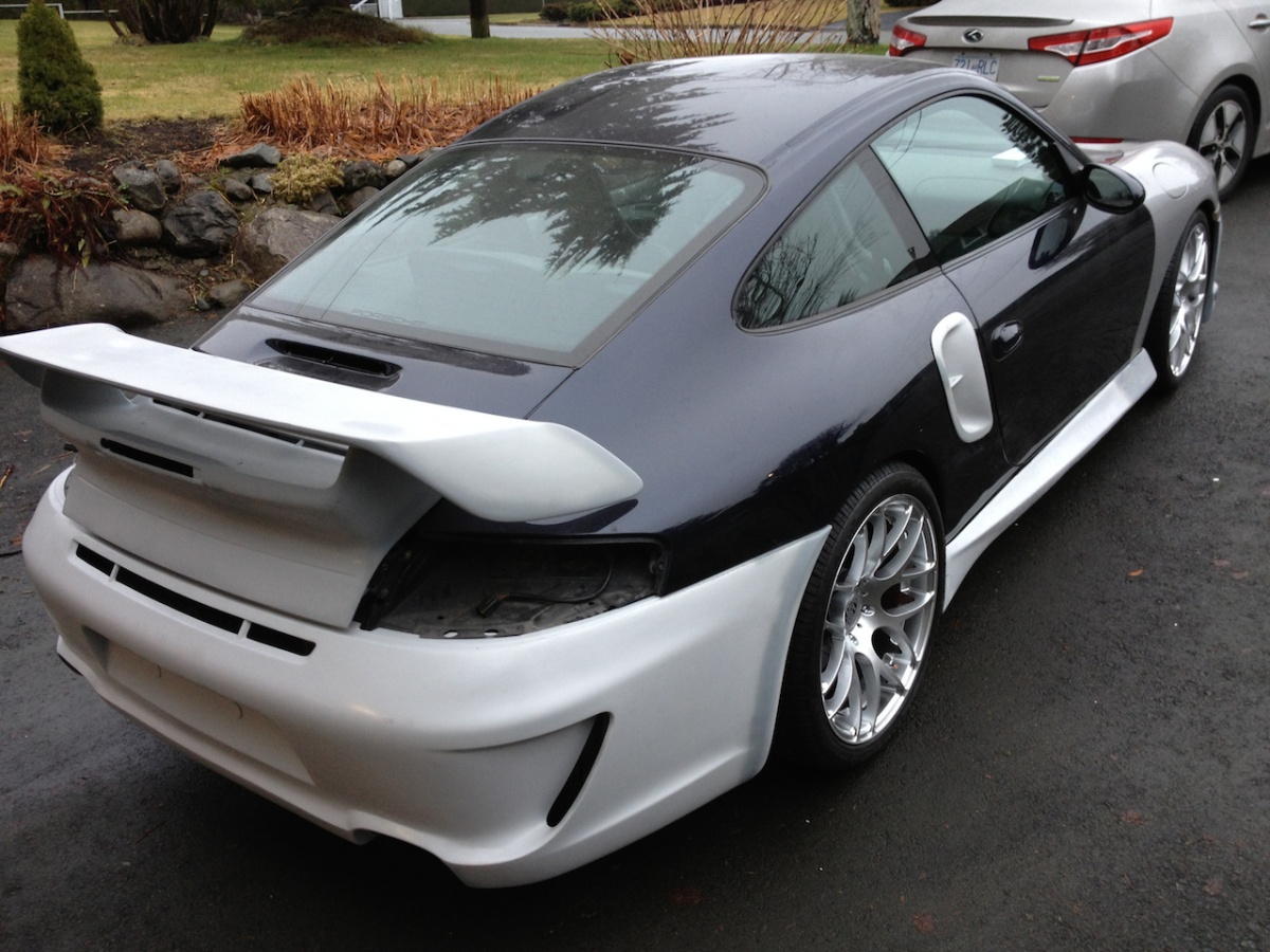

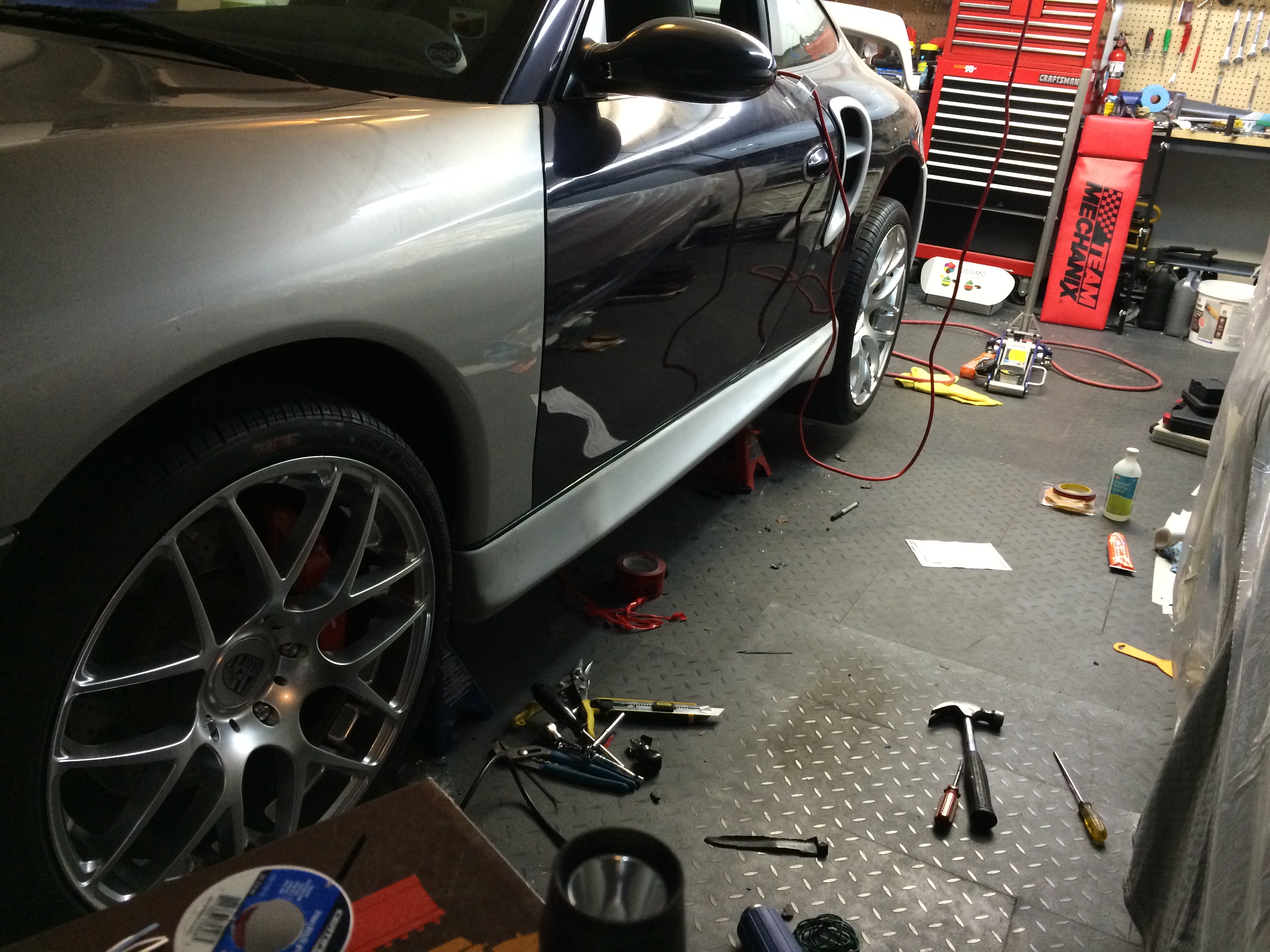

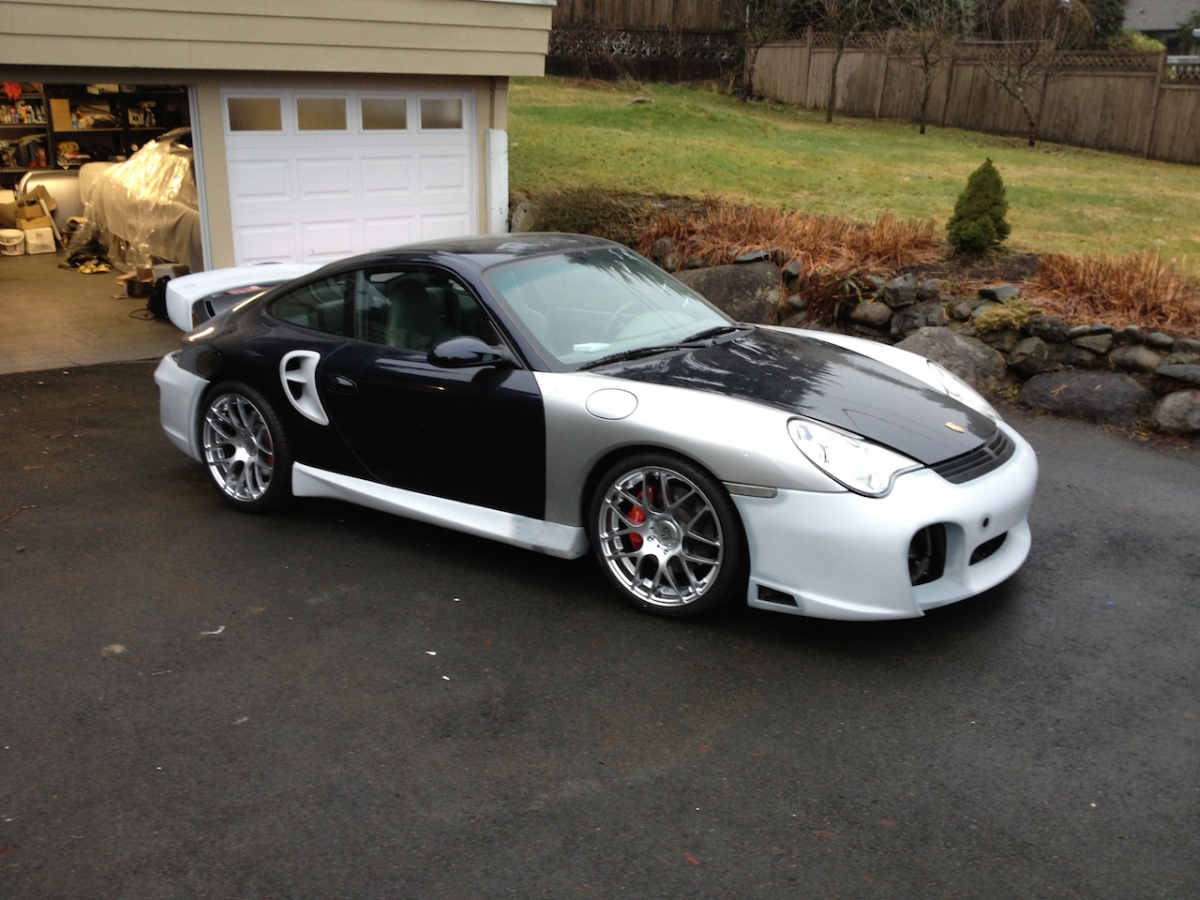

Well this project is taking a long time... welcome to the world of taking an MBA and having twin two year olds...
Anyways, Had to take it out today for a delivery and thought I'd show the progress while it was out of the garage. I am determined to have it back on the road this summer...
Cheers
Aaron

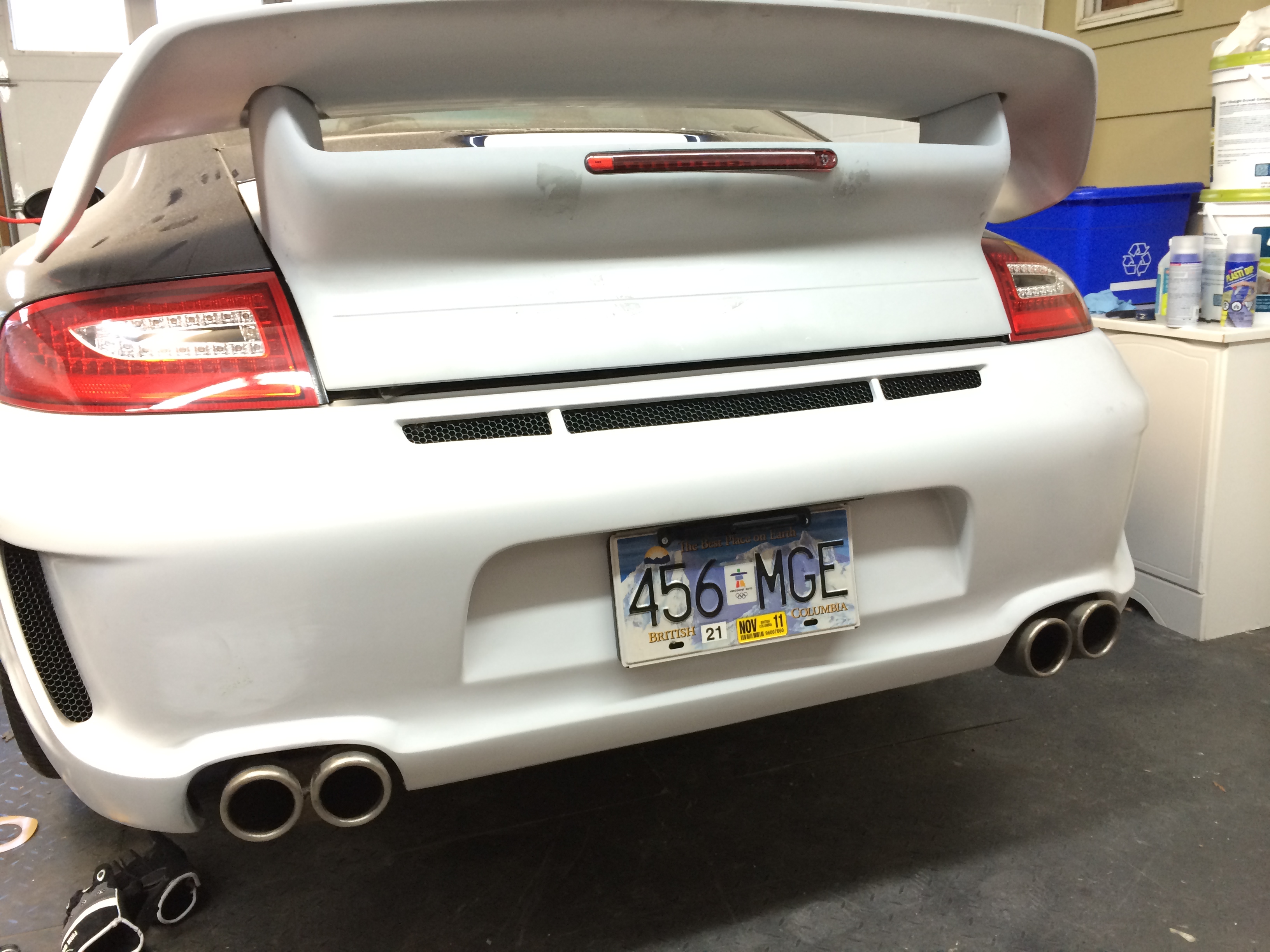

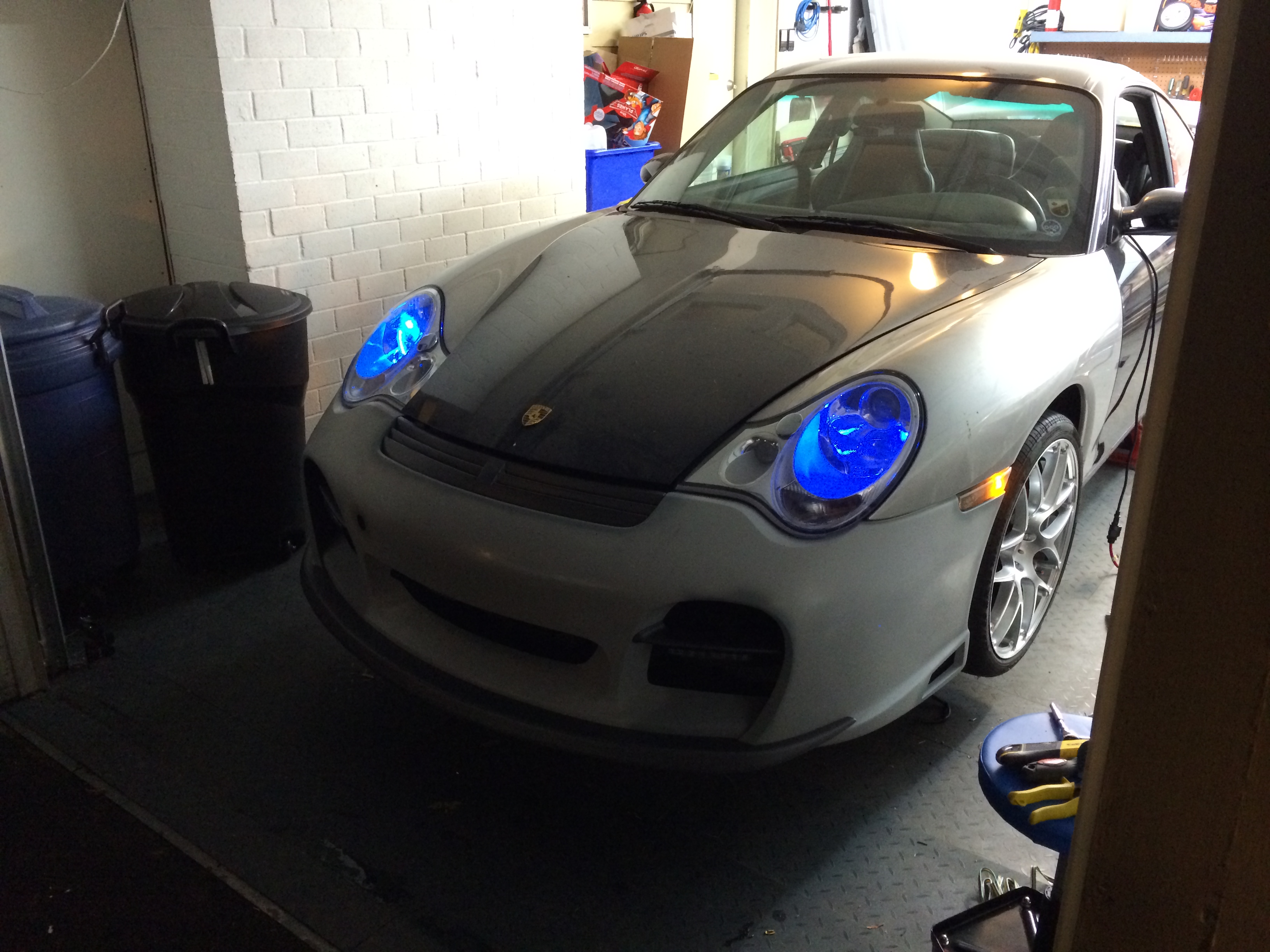

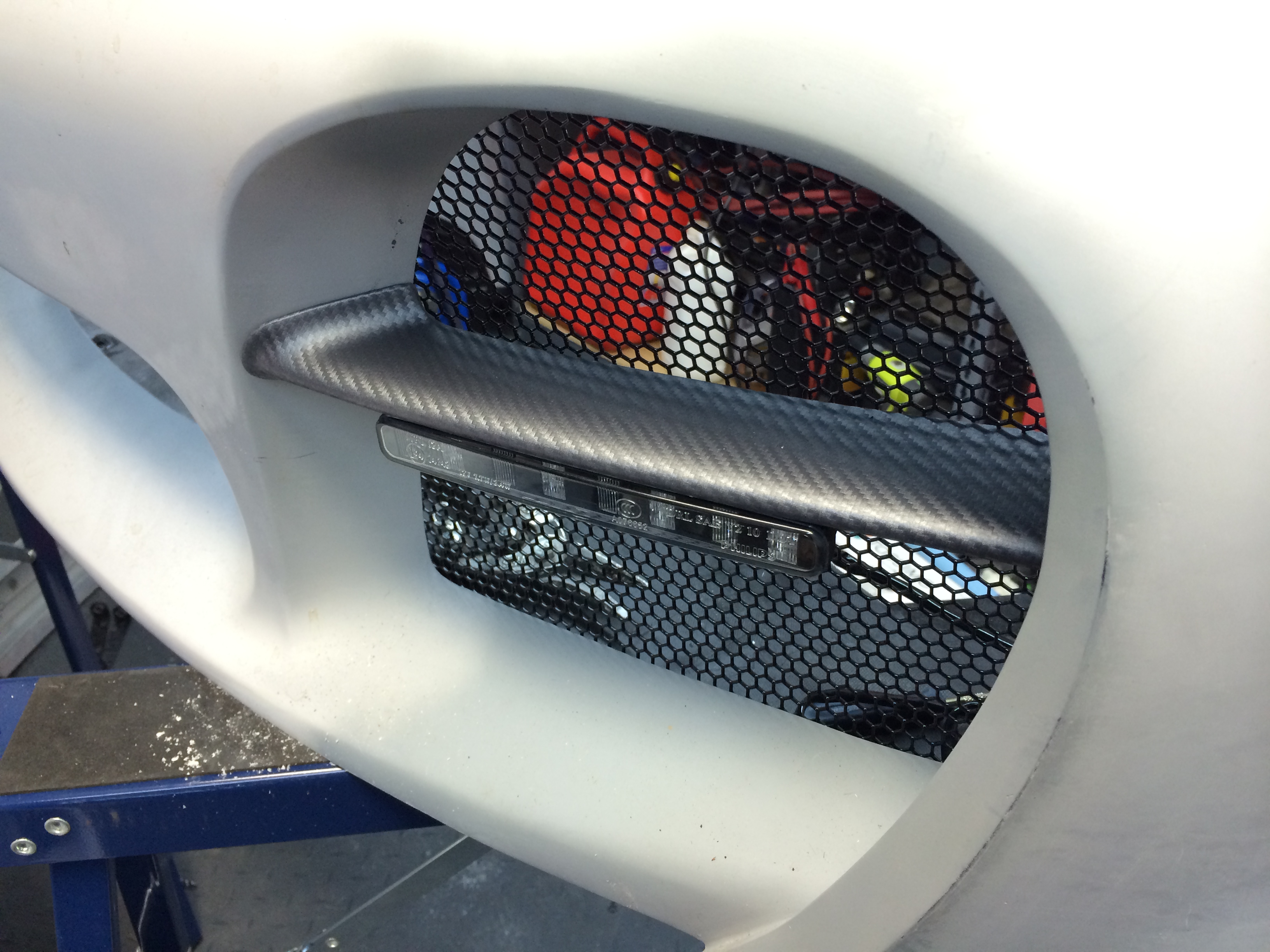

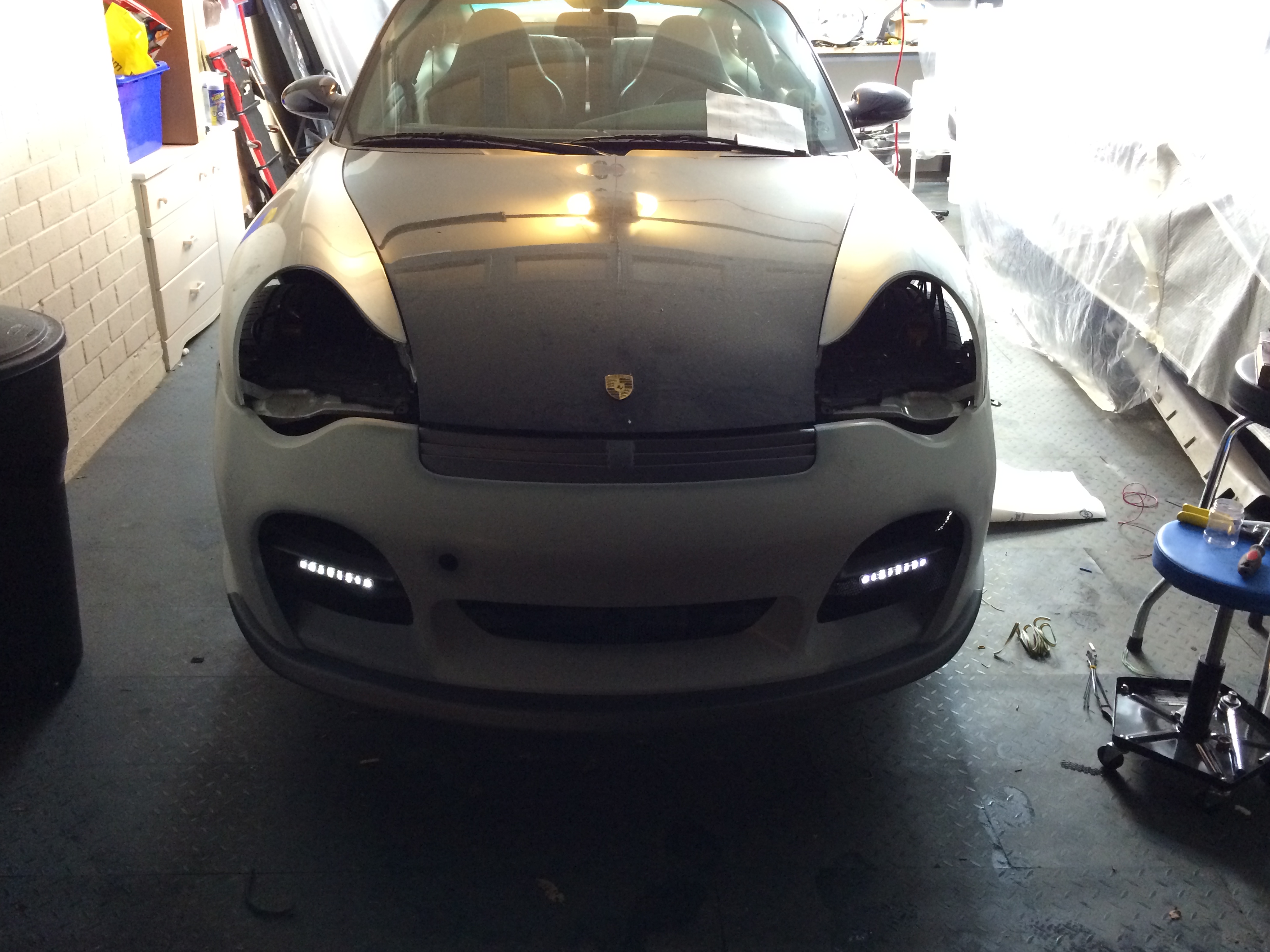

I am reviving my thread... It has been a very long time since I posted on here as the car didn't get much love last year with finishing off my MBA, kids, work, yadda yadda...
Anyways, I made a project plan and am on pace with having it on the road this Spring. Here are some updated pics... Not so sure about the LED parking lights in blue, may shift to white. That's a minor change later though...
Cheers

That's looking very nice! I'm curious about the amount of labor to mount the new bumper cover. I'm looking at getting a 997.2 GT3 style for my 99 C2 NB (front bumper cover only) from Precision Porsche or the Xtreme product and am wondering if this is something I can install myself. I have removed my OEM GT aero front a few times to clean/work on radiators which is a relatively easy job. How much fitting do the new front bumper covers require? That rear looks nice as well, how complicated are those to DIY?
thanks
Rich

Cant say I am a fan of the blue... Go white.
Where is the paint? Its 2014!!
Ya, I'll probably switch it. Don't know until you try, right?
Haha, as I said, finishing an MBA and raising twin boys can be a little distracting. It will be done by Spring (March/April).
thanks
Rich
If you've taken them off before, same deal. Depending on the bumper, you may have to trim the crash bar a bit, but that's simple.
Cheers
Aaron

What rear bumper is that and any fitment/finish issues? Was eventually thinking of going with that same style bumper. GT3tek have the Polyurethane version but haven't heard too many reviews on it.
