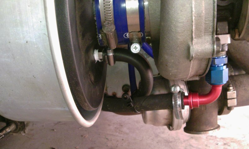

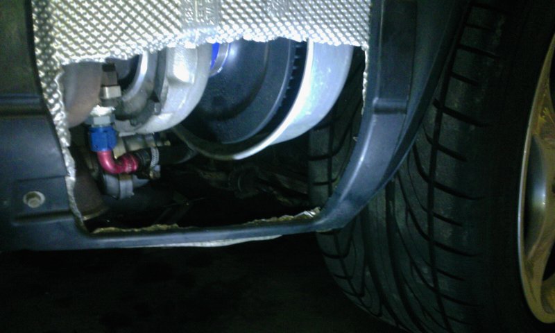

I purchased the used IMA TWIN TURBO kit from 6SPEEDER three months ago And I installed all myself for two months. A scavenge pump, injectors, and oil line fittings is needed in addition to a kit. The computer is tuned up using E-MANAGE ULTIMATE and is running with 6.3PSI boost (There is still some uncomfortable point depending on MAF sensor, but no hesitation with WOT). If someone who want to install turbo kit which has no DME option for cable throttle '98-'99 996, it is able to manage by e-manage ultimate, piggyback controler. I am evidence.
I have never dyno yet because I use inner silencer to make exhaust sound quiet, which restricts exhaust flow = reduce power. It is toooo loud only the "pipe" so I have to make muffler at first!!
I appreciate Ivan@IMA MOTOR SPORTS which gave me advices, though the kit was traded one.
PS
Dan@vivid racing, I exchanged many informations about the turbo kit of your company but did not purchase after all because of problem that how DME to be managed at that time. But later, control by E-MANAGE was in prospect and then used twin turbo kit was there timely. I am sorry but greatly appreciate your kindness.
