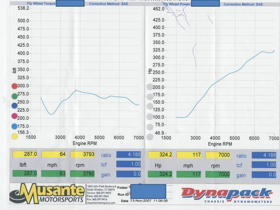

Here's an old dyno sheet after the mods (this was with my previous Maxspeed full exhaust)

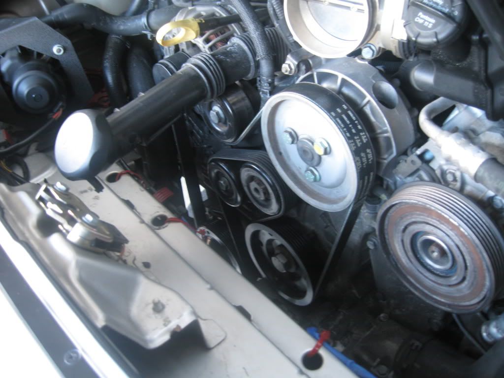

Recently installed the RSS Underdrive pulley (and bypassed the A/C Compressor). This is a real nice mod.

Sometimes I forget what bolt on's I have. I have it too along with EVOM Intake, GIAC and GHL exhaust. I know from several fun runs that I'm quicker than stock 996's and a little quicker than 996"S" with exhaust mods. I did dyno too years ago. I'd have to find the numbers but I think I recall 300whp using a dynojet machine.

It's a smaller diameter crank pulley and smaller belt. Therefore you slow the use of the other accessories (alternator, power steering, water pump and a/c compressor). The slowing of those accessories frees up WHP. I had a problem with my a/c compressor, so for now I bypassed that as well (therefore using an even smaller belt). I can definitely feel seat-of-the-pants gains. The power feels more much more contiguous...

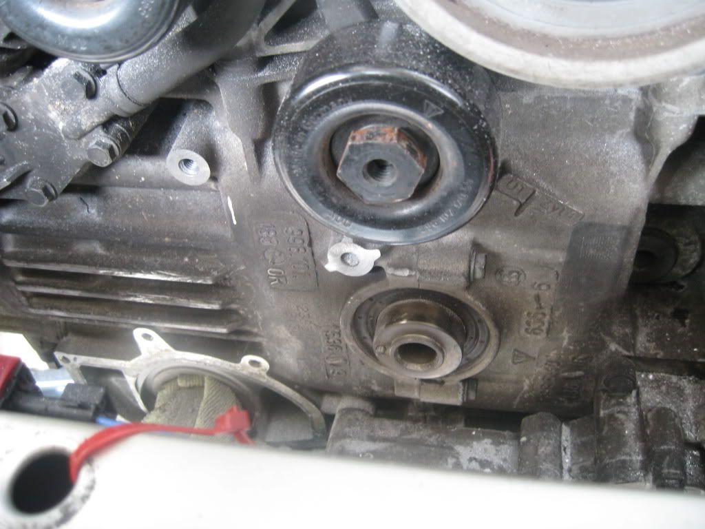

RSS does not supply the belt but it's a common Gates belt that can be had locally. The install is pretty straight forward. The only "tricky process" is shaving down the Timing Boss which is a small metal part that sticks out of the block. For that you will need a powered grinder. Here's a picture of the boss after being removed (see clear silver area) and the pulley installed. Notice I was changing out my water pump as well...It's easier to do the water pump with the crank pulley removed.
