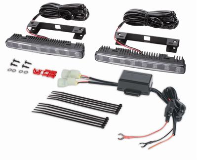

Balefire how did the DRL's mount ? I have the same model< and I like the colored botom lip how does it hold up to chips I have to spay mine every now and then

Nice job with the LED DRLs. The integrate nicely into the front grills. How are the attached and wired?

Without removing the bumper, I wired the lights from the grills to the hood latch mechanism using a coat hanger. I placed the control module in the frunk and connected it to the battery. Then the lights cords were tunnelled around the trunk trim to the control module. Finally I used Scotts 10lb double sided tape to secure the lights to the grill. Thats it.The lights turn on/off with the car.
The hardest part was wiring the passenger grill to the hood latch.
I could have used the supplied screws and housing, but the light would have protruded pretty far from the grill and looked ugly.
The double sided tape has held up to multiple car washes. The ideal double sided tape is 3M VHB tape which is almost like super glue.

Are the front lights mounted to the grill using screws? I've seen some kits that use adhesive tape, and that doesn't seem too secure to me...

oops. forgot to mention.
I could have used the supplied screws and housing, but the light would have protruded pretty far from the grill and looked ugly. So I used Scotts 10lb double sided tape. The double sided tape has held up to multiple car washes. The ideal double sided tape is 3M VHB tape which is almost like super glue.

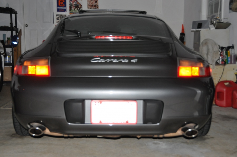

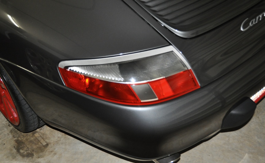

Finally got them and love them.
I know you have seen pics already but here are a few more before and after:

Jcusa,
Your car is a 2001 C4? So, these rear tails fit WB? I thought they didn't make them for WB. Are '01 C4/C4S NB? I need some correction here. Lol.

Very Nice! Btw, i love your car color choices. One day I'll be bold enough to go blue wheels and accents for my son...

No his car is a NB. The C4S which began in 2002 was a WB. C2/C4 is a NB. And the Dectanes still aren't available in WB as far as I know.

Balefire, Thanks! I think your car looks sharp.
Shecky, he's spot-on. My car is a NB the 4S is the WB and the LEDs for the WBs will be out late this summer, at least that is what I was told.
