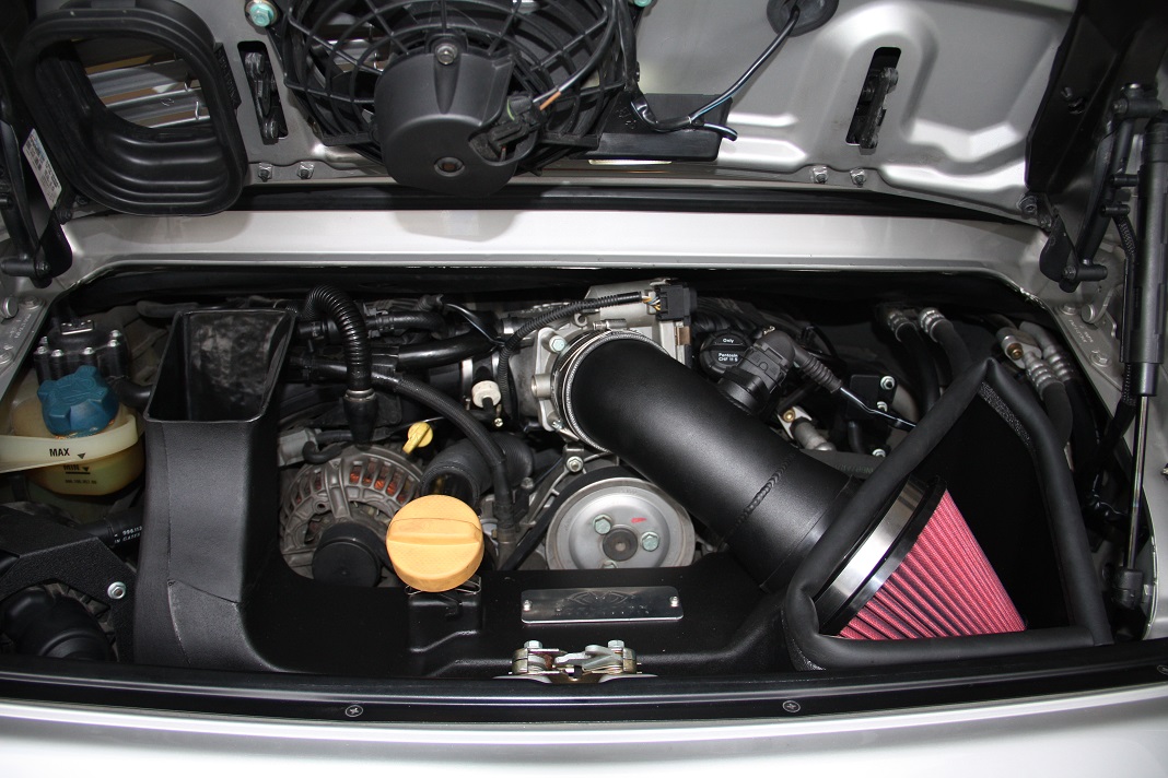

Dont know if it helps, but I am running the car with Evoms Cai. never had a problem with CELīs or blown maf.
No oil in the filter, and works like a charm
