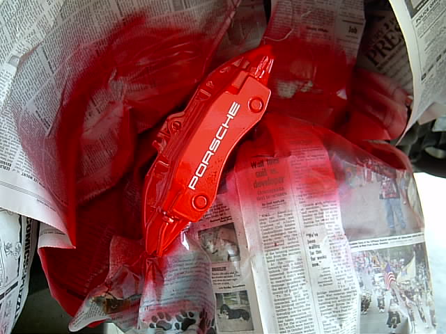

the car looks sweet, how deep are the rear wheel dish? Did you have the brakes painted red? They look great !

Robert,
The rears are 19x11 with a 3" high polished lip. Ideally I would like to have my calipers powder coated...but I decided to give it a try first.
Started off with removing the pads from the calipers then hung them from the springs using a fine wire. Mask off the car and work area. Using brake cleaner solution and a small wire brush, cleaned off the difficult areas. Proceeded to use 150 grit sandpaper to create a rough are for the paint to stick. Masked off the bleeder valve and pistons then with even strokes applied 6 coats of plastic-cote red brake caliper paint.
The next step was probably the trickiest because you only get one shot at it...apply the PORSCHE decals. Finished off with shooting 5 coats of high temperature clear coat.
Here are some pics
