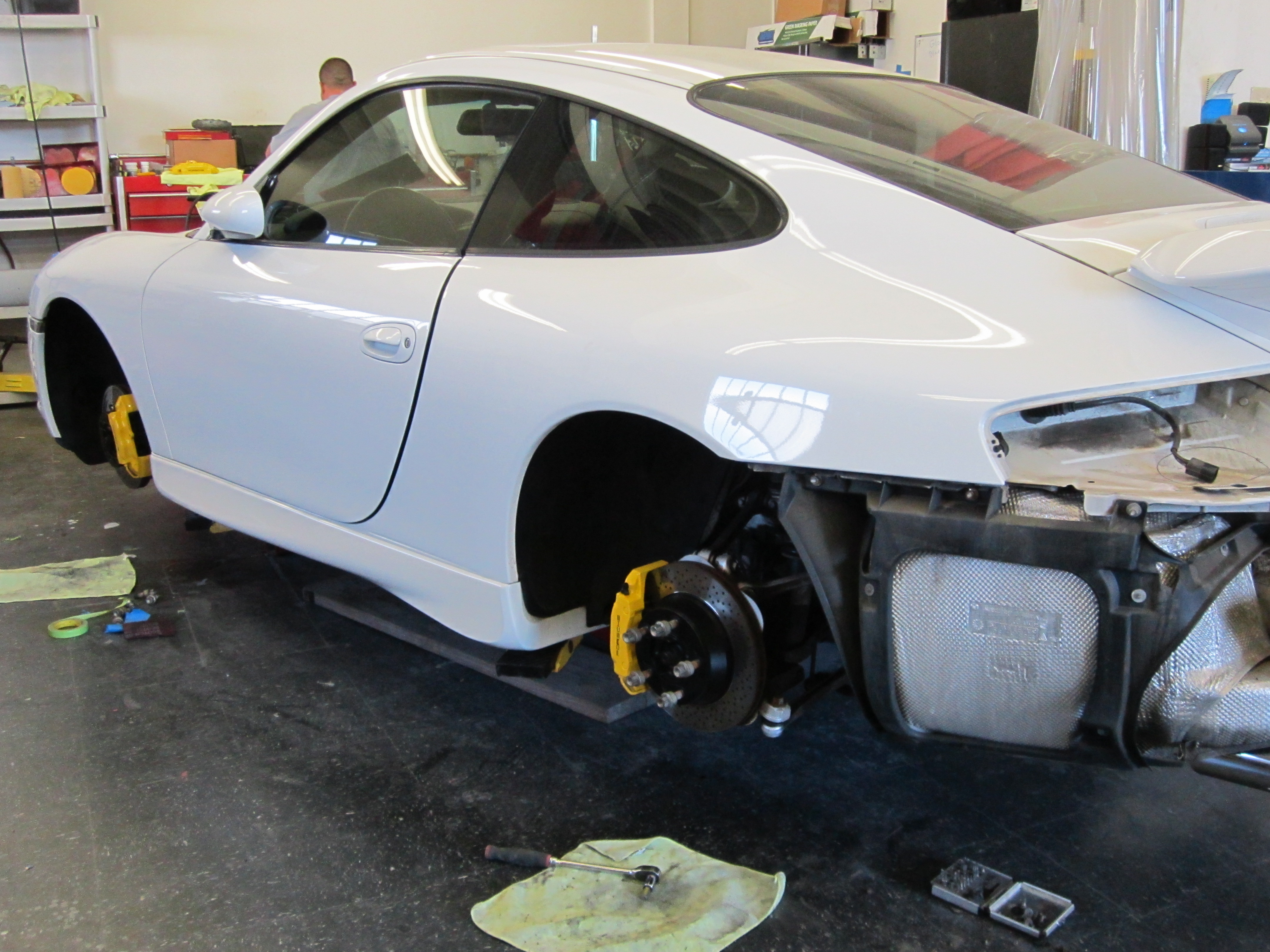

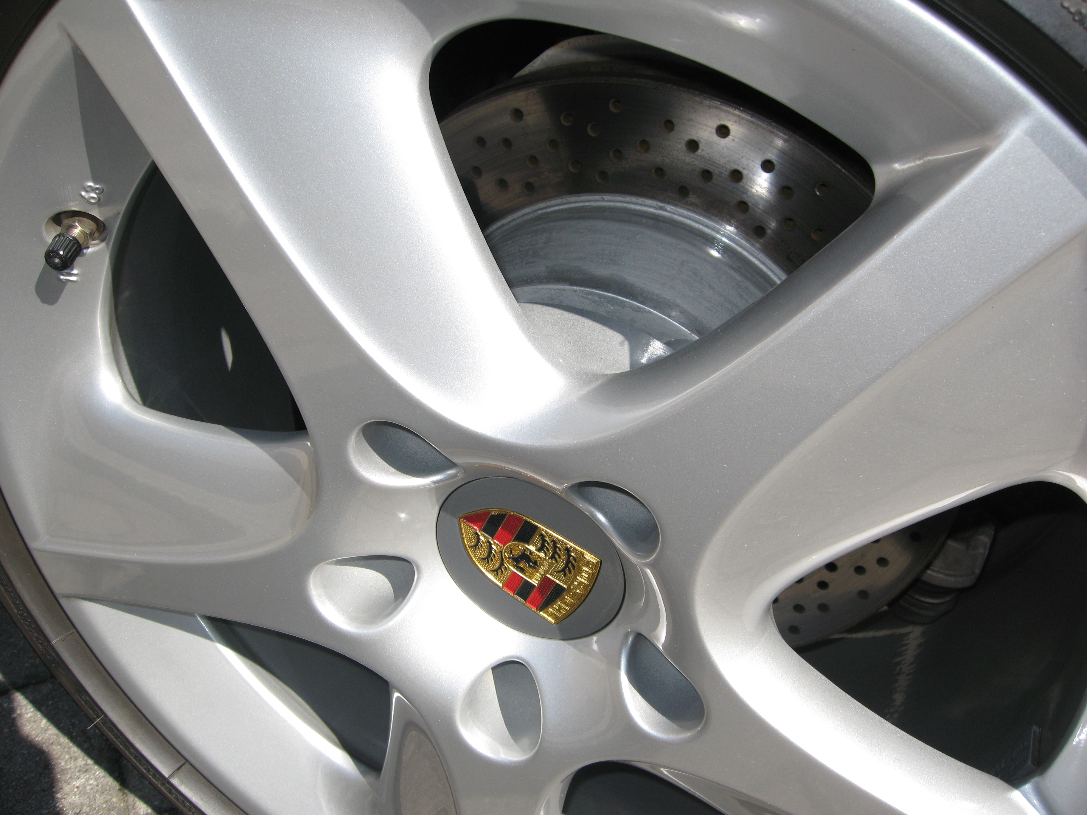

I used spray caliper paint also. And it came out great!

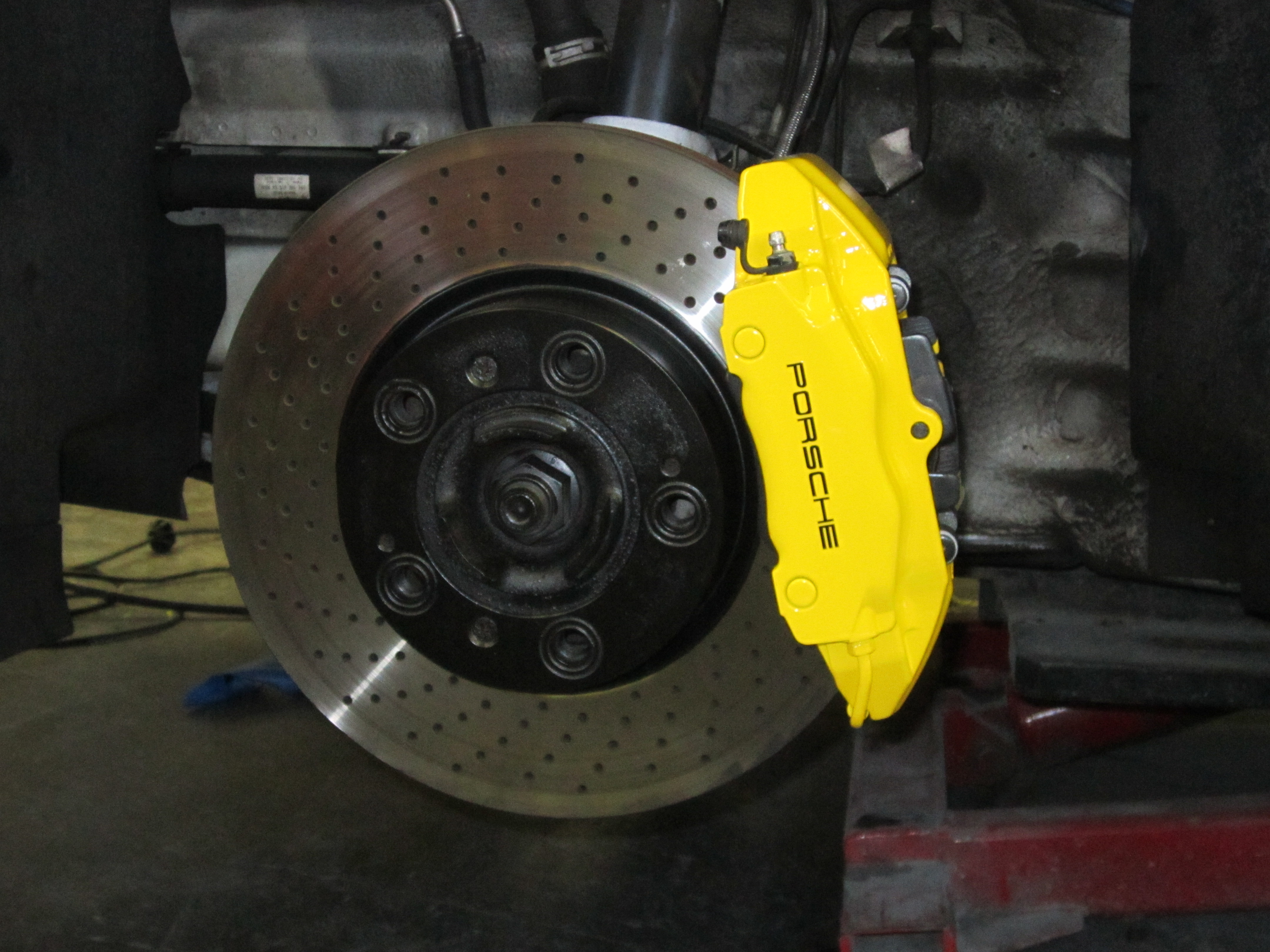

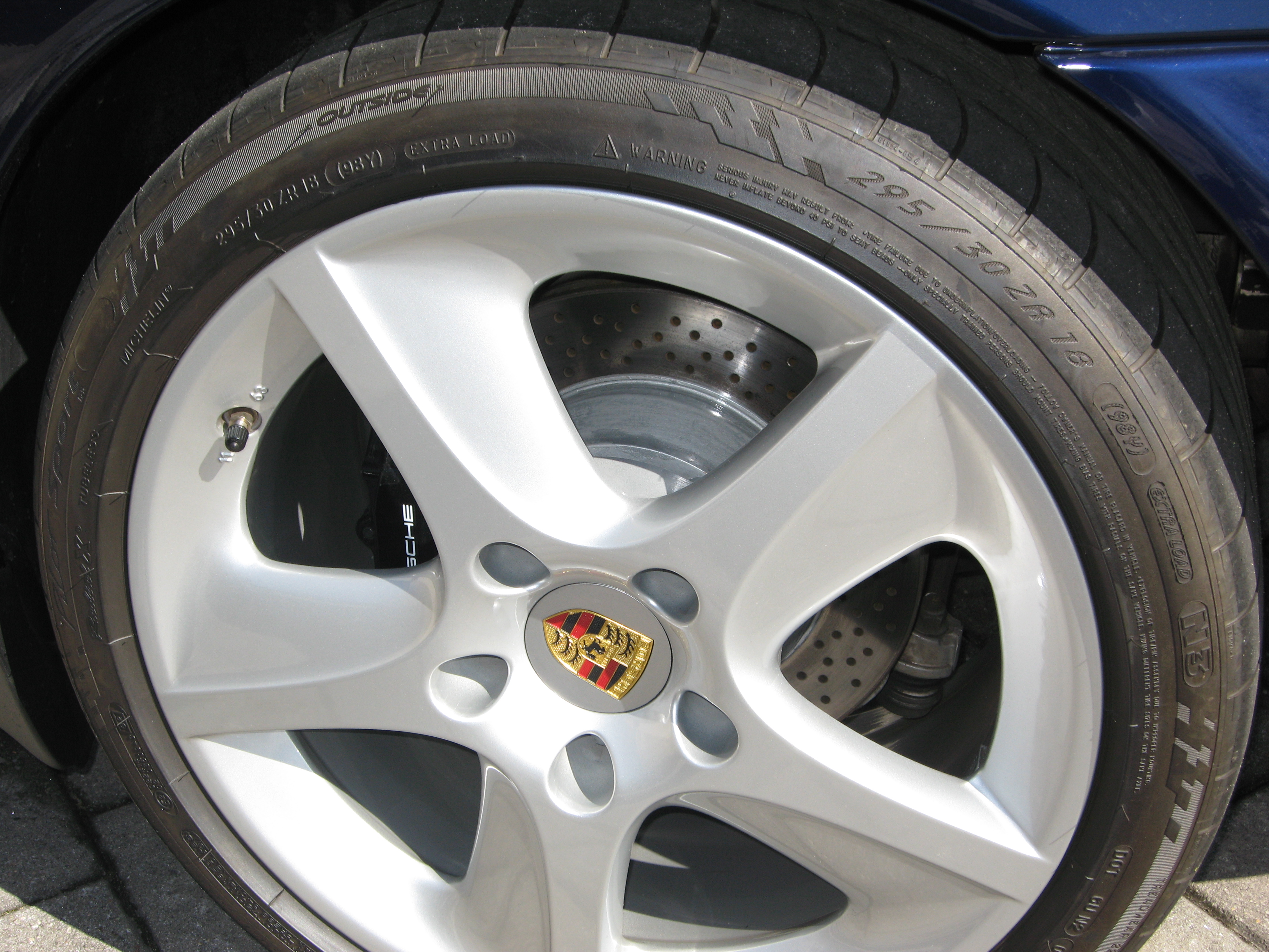

Using POR-15 Rust Preventive paint in silver, I did two light coats with light sanding in between. The paint is very runny, so it's important to keep the coats light. While I'm sure the results would have been better with the spray version of this paint (which would have avoided brush marks), I'm still happy with the results.
