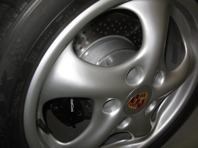

I used spray caliper paint. The key is prep, of course. I have a lift, so 4 wheels in the air at the same time. Some pics. Did the rotors over 4 years ago. The parking lot shot was a few days ago. Still look great.

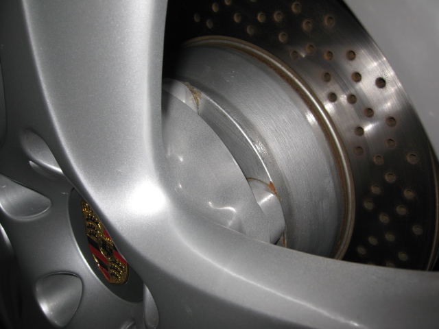

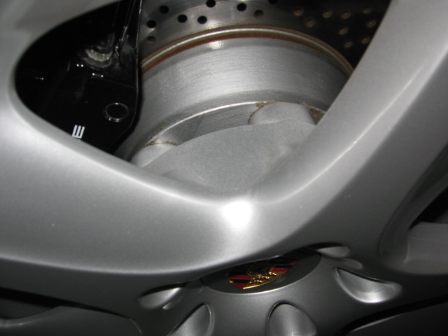

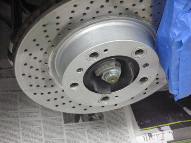

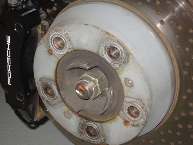

Here are my before and after photos. As you can see, my rotors hats didn't look so bad. I just had a couple of rust spots and chips here and there.
It turned out very nicely, though if you look carefully, you can see a bit of the brush marks. I did two coats of paint on each rotor, waiting about a half hour in between coats. I then let it dry and harden between 6-10 hours before I put each wheel back on. The Rustoleum hammered finish paint dries very quickly, which means you have to work fast. To get to the part of the rotor hat closest to the braking surface, you should use a 1/2" bristle brush. The rest you can do with a 2" foam brush.
If you're looking for a Rustoleum color that comes closest to matching the factory finish, I believe that would be Smoke Grey.
Thanks to all for the tips.

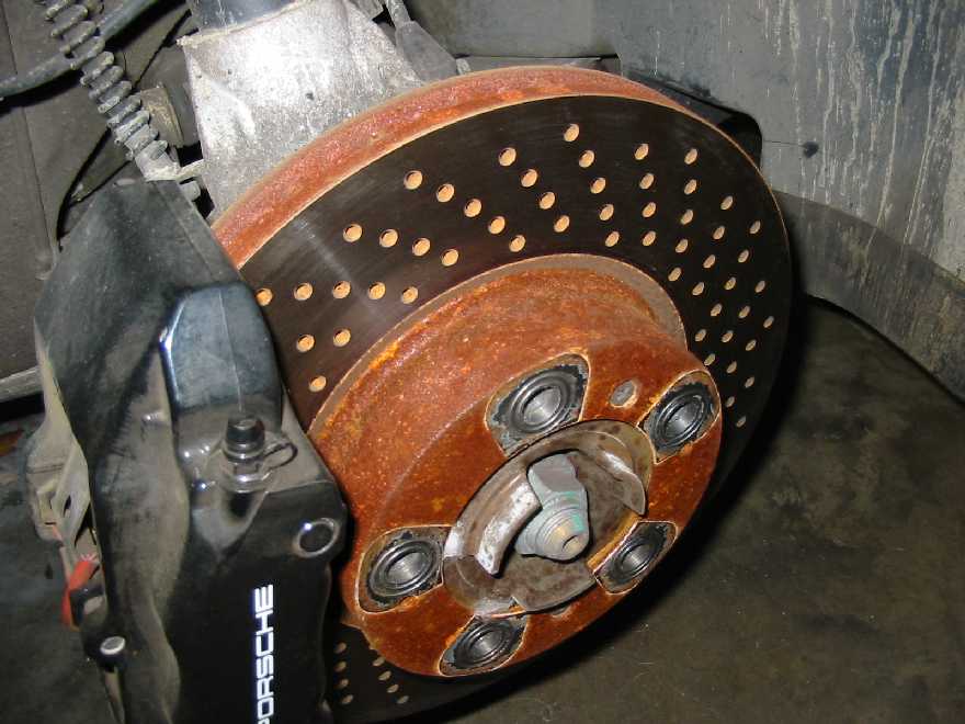

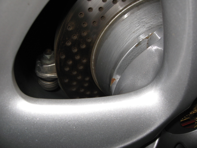

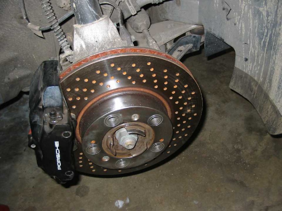

Long-Term Update
Well, it's now 3 years and 3 months since I painted my rotor hats, and I'm not so happy with the long-term results. As you can see from the photos, the Rustoleum Hammered paint has started to chip and peel, revealing the rusting rotor hats again. And in that time period, I've put only around 1,300 (one thousand three hundred) miles on the car, with none of it on wet roads. I think the issue is that this paint cannot stand up to the high temperatures generated by rotors.
I'm thinking of buying high heat brush on manifold paint from Eastwood Company, which has a dull silver finish to it. I don't want to use spray paint since it tends to go all over the place.
Any other suggestions or ideas?
