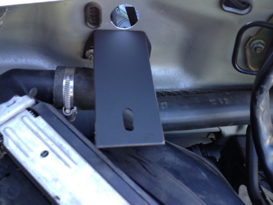

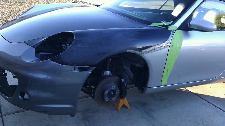

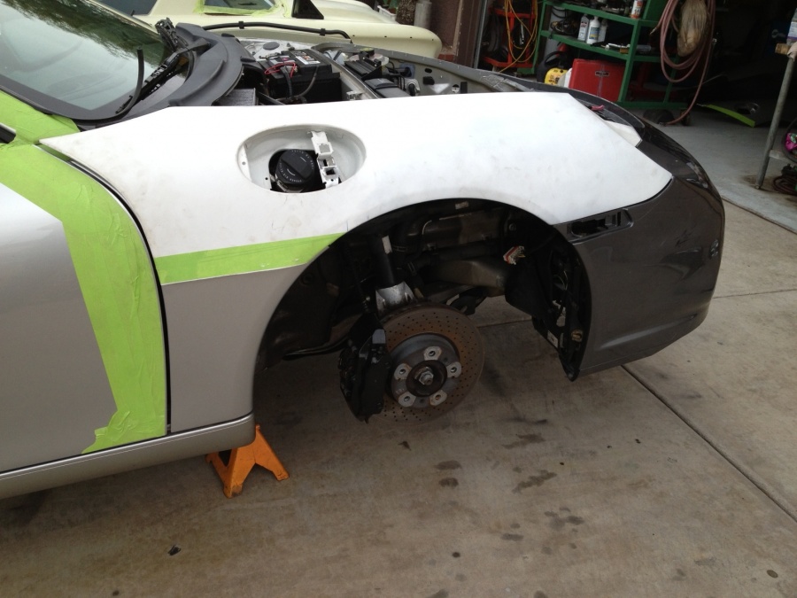

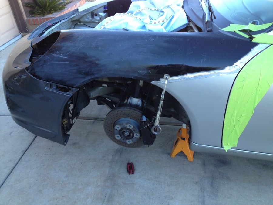

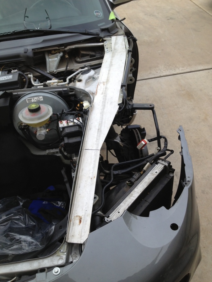

Update
Both fenders have been cut and welded. Check out the perfect line between the door and fender.
Had to fabricate a forward upper bracket, see pic. Other bracket (rod) next to the radiator bottom works great.

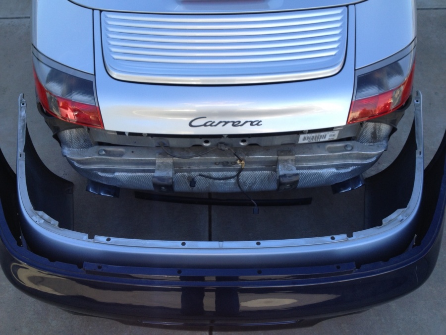

Turbo rear bumper is much larger than C2 stock bumper. As stated in other threads/forums the rear turbo bumper will fit with some modifications:
- Bumper needs to be shimmed a little over a 1/4 inch near the rear
decklid cover, see pic. Has not yet been shimmed! Will post future
pics afterwards.
- Pulled the upper corners forward into the wheel well. Needs to have a
little over 1/2 inch cut off, additional cuts/welds required in the bumper.
Will post detailed pics later this week on the bumper mods.

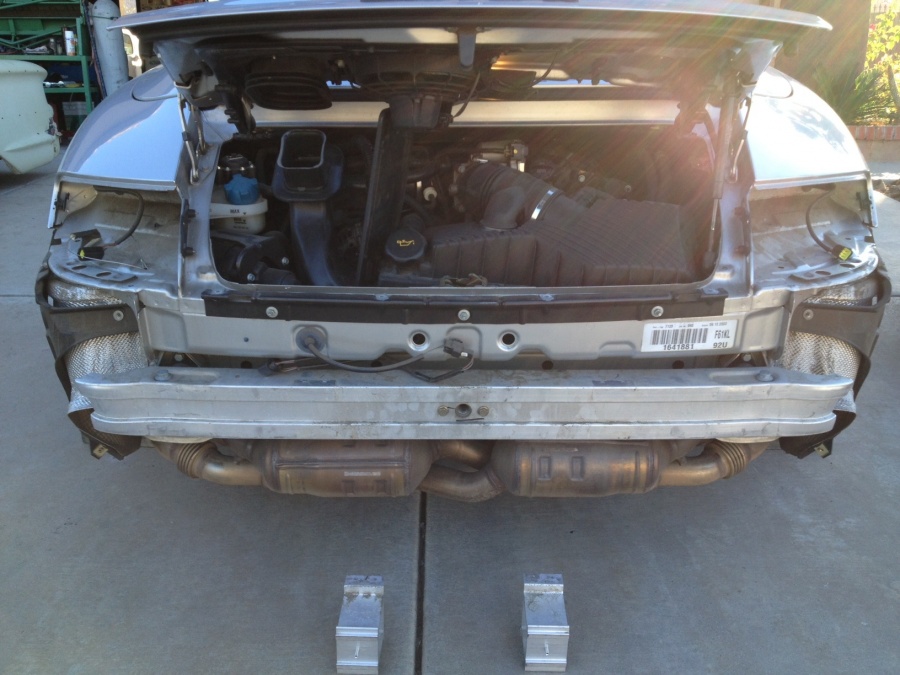

Rear exhaust tips need to be modified, placement on turbo bumper is inward toward the center.
Anyone considering an OEM rear turbo upgrade on their C2 should remember that turbo bumperettes and mounting brackets for the bumperettes are necessary.

Looks like its coming along. That weld line is a new one and I must say very surprised that the wheel opening lines line up to each other. Great job and definitely saves on having to reshape the door/fender line area as others had to do.
We decided to maintain the original fasteners/996 fender near the door. The weld is longer, however the blend into the door and fender arch seems much better.
Maintaining the original fender bottom make it easier to source the side skirts for fitment. Currently undecided between the GT3 or TK (line runs up into the door) side skirts.

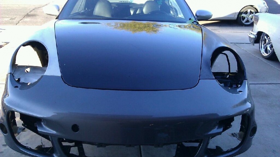

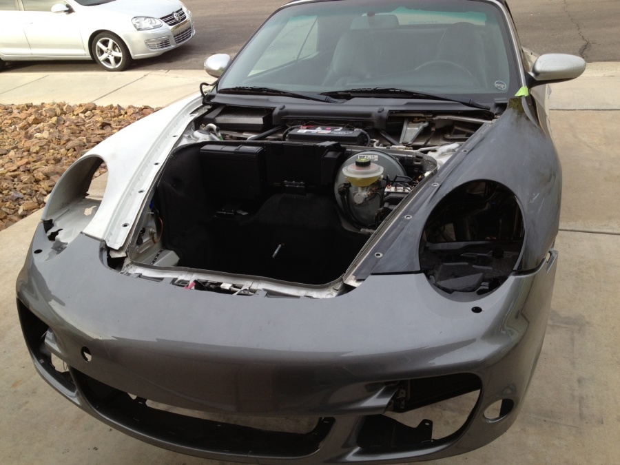

997 hinges do not lay flat; hinges step upward towards the rear. Fabricated mounts out of stainless to weld into place. 997 hinge struts are needed as well, they are about an inch longer, opening the hood higher.
A couple pics of lines coming together with fenders, bumper, and hood. Everything is lining up perfectly.

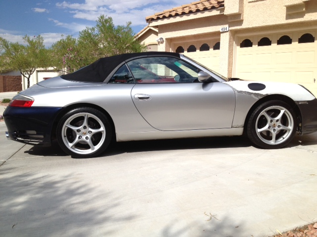

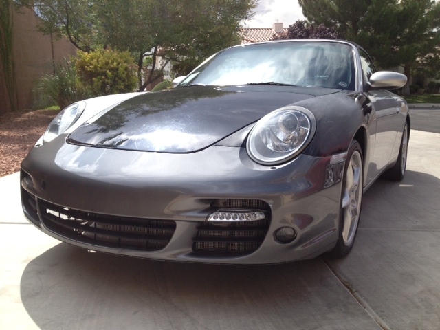

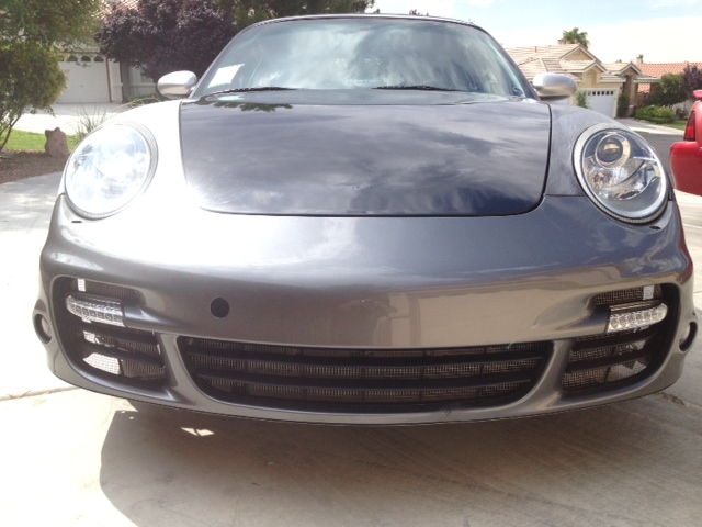

Glad you asked!
Out of commission due to a serious back injury, just recently got back on my feet. Currently driving!
Car progress is as follows;
-Fenders welded in place and fitted.
-Hood in place
-Headlights in place and rewired using existing plug
-Side markers
-Front Bumper fitted with LED's, Fogs, & Grills

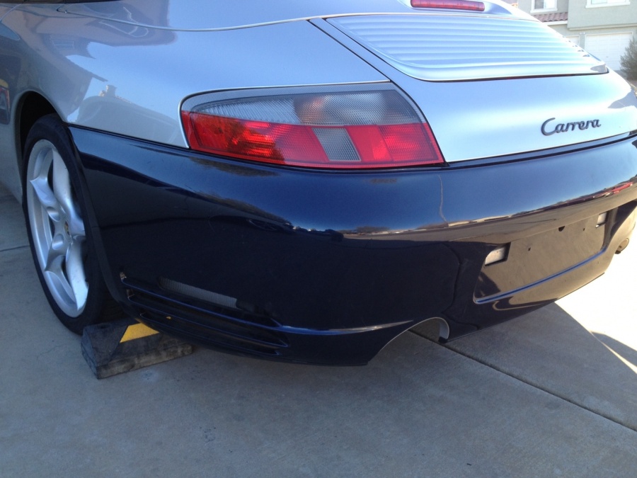

-996 Turbo rear bumper in place
-c4s exhaust pipes and tips
To be completed
-Turbo 996 rear decklid OEM with hydraulics
-Turbo 997 rear Wing OEM (larger, wider than 996)
-Turbo 997 mirrors
-GT2 Side skirts
-body/prep/paint stock silver
19" RPK-065 or Roderick RW5 wheels & 305/30 & 235/35's. Still undecided on the wheels. Open to suggestions/experiences/etc.
Included a few pics:

Do you have any more pics of the rear bumper? Also what is your opinion on the fitment. I know people bend the ends in to fit but I assume the rear middle will be somewhat bowed out and not fully seated against the inner bumper beam?
