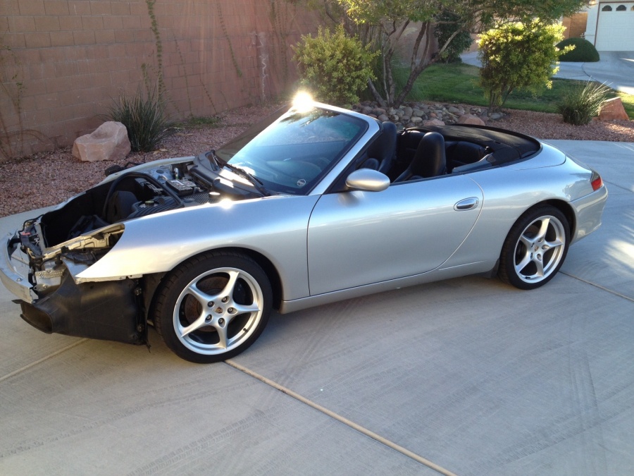

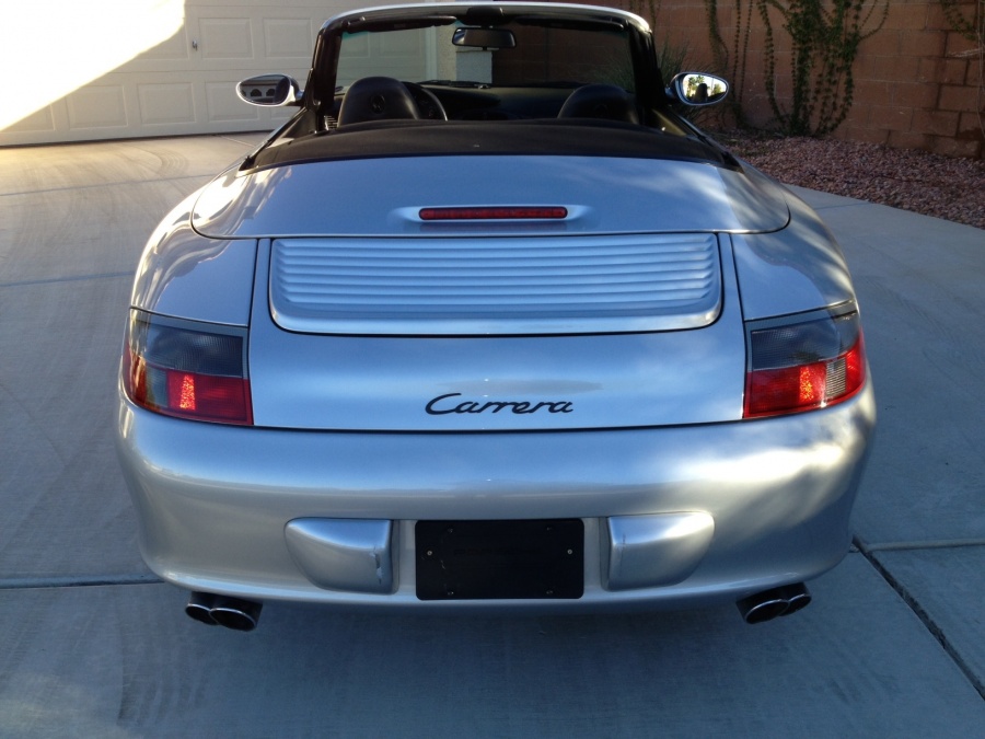

2004 C2 Cab 6speed 61k miles salvage title bought/delivered from a MO auto salvage dealer.
Damage included P-side fender, front bumper cover, Xenon headlight, hood, and a slight dent (1/2-3/4") on the tub. Suspension and frame/body/alignment check out with no measurable damage.
Got lucky on the tires, almost new and a very well maintained Porsche, no leaks, no strange sounds, and the interior is near perfect.

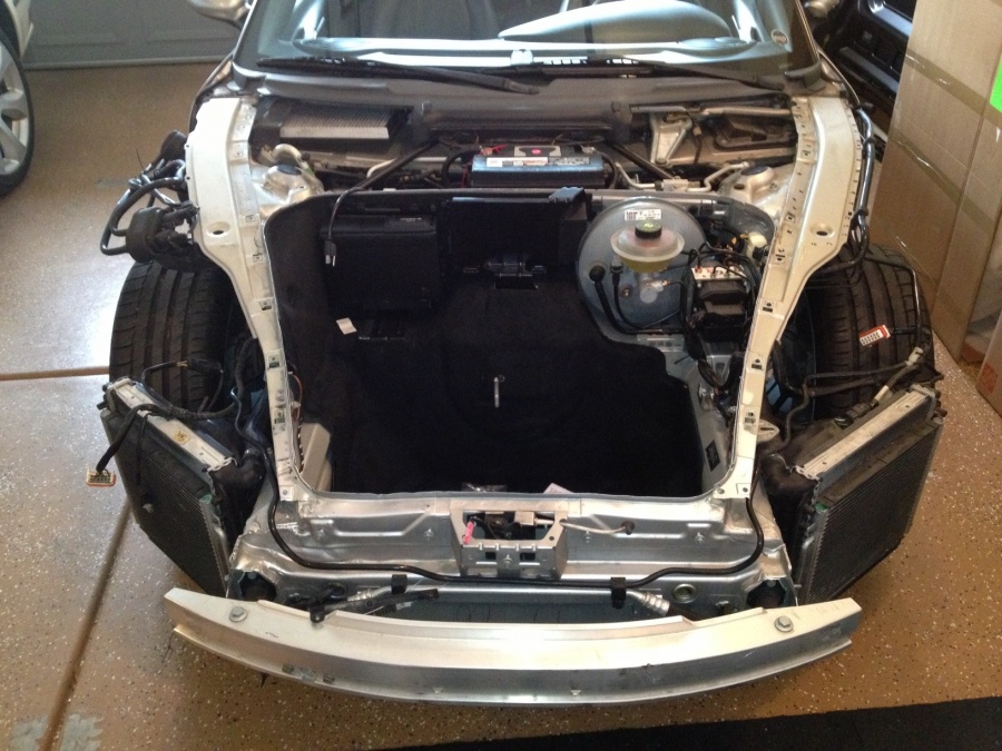

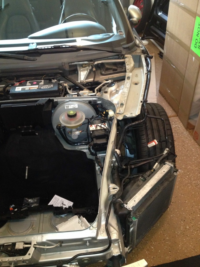

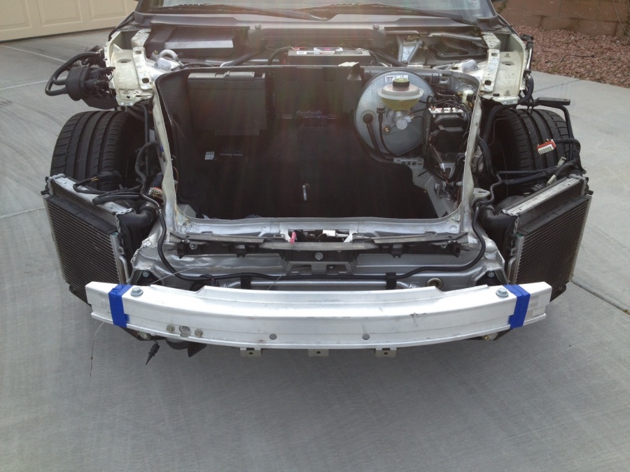

Today's progress:
-removed fender
-removed hood
-removed most trunk components/carpet
-removed upper section of tub rails. (drilled tack welds)
-Tomorrow:
-cutting front aluminum bumper ends
-removing rear bumper cover
-remove exhaust tips (prepare to move to accommodate turbo bumper
cover)
-remove additional tub components/carpet

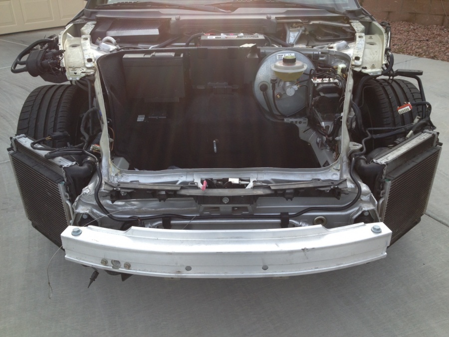

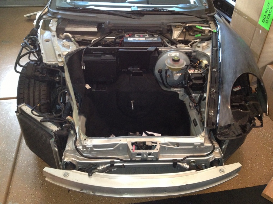

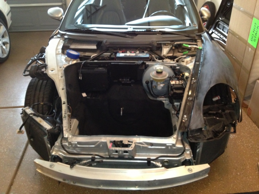

Additional pics with fenders, hood, bumper temporally in place. None are attached for fitment at this time.

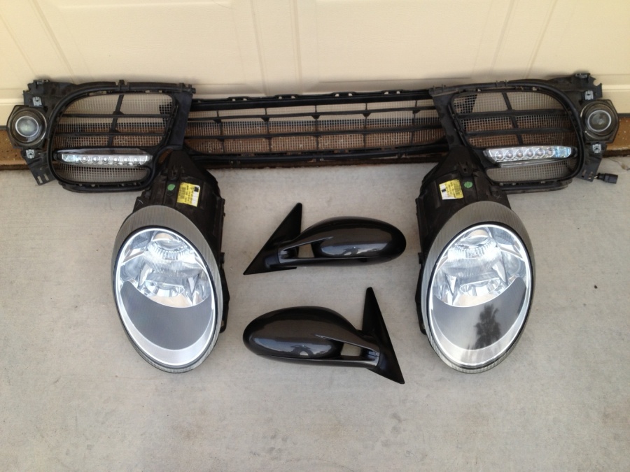

Looks like some good progress. Do you happen to have any fitment pics of the frp conversion fenders by chance?
Also good luck sourcing the LEDs for that turbo front bumper for a reasonable price.
Got the OEM LED's...see pic

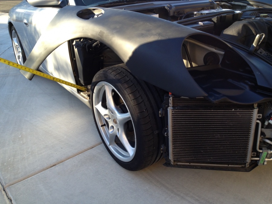

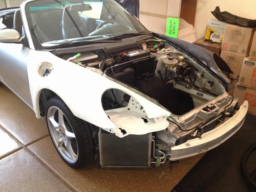

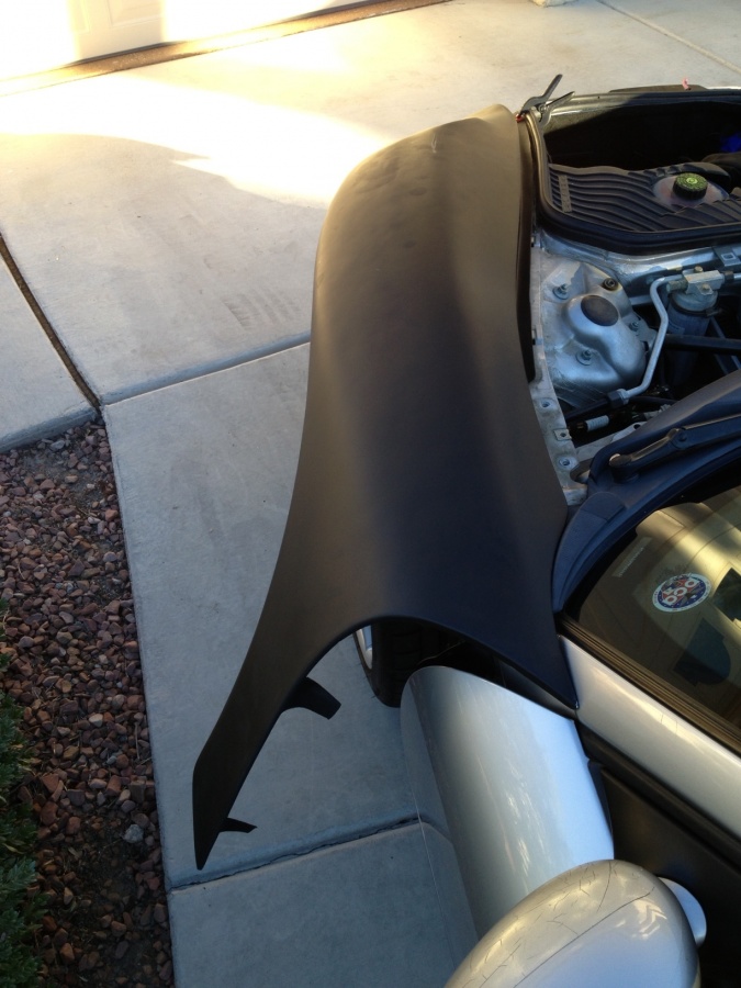

See pics...
****NOTE**** Not using the FRP Duraflex Fenders pictured, in progress of cutting 4 steel OEM fenders, pics tomorrow!
Some progress today includes:
-cutting 3.5 in. off each side of bumper - pics included
-cut the first fenders pass side - pics on this tomorrow
See pics...
OMG!!! ARE YOU SERIOUS!!! I can't believe those conversion fenders would be THAT BAD. You sure the fabricator wasn't drunk or something? I really hope you get a refund for those or I would dispute it at the least with your CC company.
Are you buying all these parts new because I know for a fact that those LEDs for the front cost a pretty penny.

...get a refund...
They gave me a full refund including shipping. Not sure why these fenders were so bad, they told me that their supplier said the other ones in stock had the same problem.
...Are you buying all these parts new...
Most of the parts are used including the LED's.

Great to hear on both counts. I did price the parts new at one point and after the 4th line item, I figured I'd stop right then and there as it didn't make too much sense to buy new. Check your PM.
