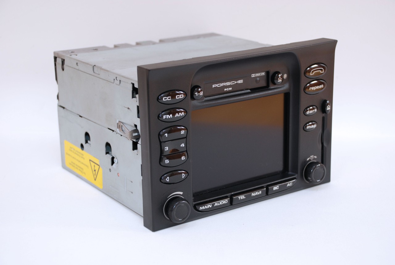

I just got a porsche 996 carrera 2, and the radio doesn't work. I press the FM AM button and nothing happens, and if I press the Audio button, there is no radios on the list, or frequencies..
My radio is like this one:
Also, the cd case in the trunk doesn't eject so I can put on the cds, I just press the eject button and it doesn't do anything.
Anyone knows if both these problems are related, and how to fix them?

looks like its time for an upgrade that one of the worst PCM Porsche ever made. You Know you can go with the Alpine 7 inch on This 996 and get a good map bluetooth and iphone/ iPod compatibility.
The NO CARD refers to a SIM Card celluar card. That unit has a sim card slot built in when it had the european phone pack installed by Motorola. IN the States they had a RAZR or a startac cradle kit on a Kuda Mount. That would have nothing to do with reception of am/fm.
Does CD work?
Is the Antenna Plugged in?
Is there after market tint on the Window? That could kill the reception.
If you have no reception at all and no cd audio my guess is a bad amp!

I was checking if all fuses were ok, and the one from the radio couldn't be checked if not removed, so I removed it (I did this because I had the radio code writeen in the manual so I figured there wouldn't be any problem with taking it out), but now it's asking me for a 4 digit code, and the 4 digit code I have written on the manual doesn't work. FUUUUUUUUUUUUUUUU
I've seen the threads where you can ask for your radio code giving out your vin, but that doesn't not work for PCM codes, does it?

Nope. PCM code cannot be found unless original code is on the card.

i would look at your option sticker under the front hood to see if your car came with the PCM. if not, it was added later on and since you don't have the correct radio code, it's useless now.
you can look up your option codes online to see what they mean. google porsche decoder.
i suspect something is not wired correct between the cd changer, amp and head unit. since you have checked fuses, the next step would be to pull the wiring.
i would agree with others that your best bet would be getting a new double DIN unit that has nav, bt, ipod, xm, and maybe rear cam. these things are getting pretty affordable. for about a grand or so, you can have it all. if budget is tight, you can skip rear cam and xm. i would also look into those head units that mirror your smart phone too.

PCM 1 w the cassette is analog. 2003+ is MOST and looks different.
