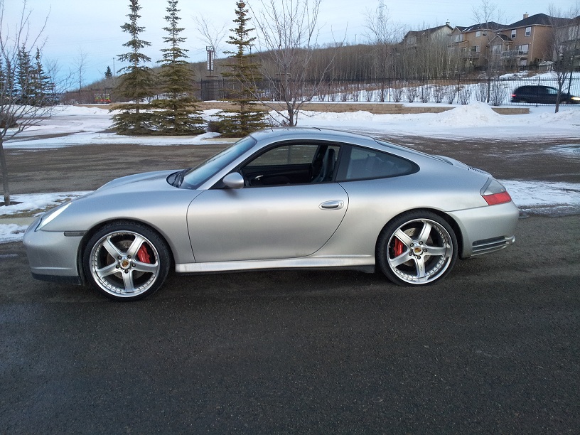

Originally Posted by VSKCHOI
no the car is not lowered, stock height, when i make turrns, it rubs against the front panel.
i dont know how to fix the problem
I'm sorry for some of the mean comments so far...
Your tires hit the front panel because they are too tall.
You can either
1) heat the fender liner and push in
2) buy new tires which are shorter, eg 235.30.20 or 225.30.20
Post pics.
Old Mar 18, 2013 | 08:41 PM
VSKCHOI's Avatar
Joined: Dec 2011
Posts: 125
VSKCHOI is infamous around these parts
You can either
Post pics.
how much of overall height is going to reduce if i use 235/30/20?
and what is the proper rear size for this set?
thanks
Old Mar 19, 2013 | 05:02 AM
balefire's Avatar
Joined: May 2010
Posts: 175
From: Chicago
balefire is just really nicebalefire is just really nicebalefire is just really nicebalefire is just really nice
thanks
http://www.miata.net/garage/tirecalc.html
245/30/20 = 25.8" diameter
235/30/20 = 25.6" diameter -> decrease of 0.2"
225/30/20 = 25.3" diameter -> decrease of 0.5"
assuming you have one of the fitments found here
http://vancouver.en.craigslist.ca/rc...550562129.html
I would run
235/30/20 or 225/30/20
295/25/20
good luck
Old Mar 19, 2013 | 07:53 AM
VSKCHOI's Avatar
Joined: Dec 2011
Posts: 125
I would run
295/25/20
good luck
hey thanks!
do you think its possible to run 235/30/20 and rear 305/25/20?
Old Mar 19, 2013 | 02:22 PM
balefire's Avatar
Joined: May 2010
Posts: 175
From: Chicago
hey thanks!
if you have a C4 or C4S, that is not ideal. there is a 1.7% difference in diameter.
you could try it, but risk damaging your differential
you should post a pic
Old Mar 19, 2013 | 02:57 PM
VSKCHOI's Avatar
Joined: Dec 2011
Posts: 125
YES i have a c4s
i will go with 235/30 front, and 295/25 rear
will post pics
Old Mar 26, 2013 | 11:08 AM
VSKCHOI's Avatar
Joined: Dec 2011
Posts: 125
Here is a pic
Old Mar 26, 2013 | 11:10 AM
VSKCHOI's Avatar
Joined: Dec 2011
Posts: 125
Another try
Old Mar 26, 2013 | 12:26 PM
Dennis C's Avatar
Joined: Jun 2008
Posts: 2,269
From: Evergreen, Colorado
Rep Power: 117
Nice looking wheels!
Is your rear tire flat in that photo? Maybe it's just the way the photo looks online...
Old Mar 26, 2013 | 09:37 PM
  #27
VSKCHOI's Avatar
Joined: Dec 2011
Posts: 125
yea its flat, i blew it, it was on 305/22
now im putting 295/25
