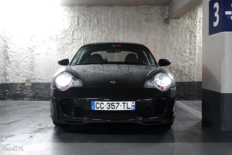

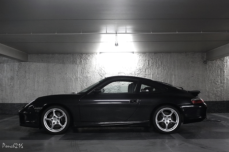

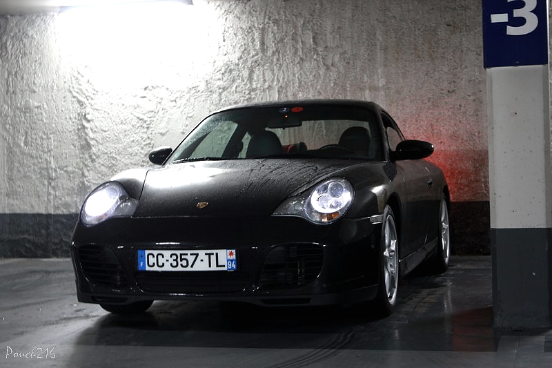

My mods are finished (4S front bumper + aerokit cup2 side skirt + RoW M030).
The side skirt were not so easy to fix: the nine clips per side are really difficult to align... And there is a hidden screw near the rear wheel... But after a long afternoon, it's ok.
